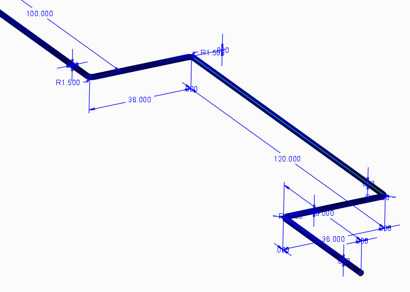

I would like to know if it's possible to adjust the angles of the "legs" used when you insert break points in a segment of pipe, then move that pipe segment.  It seems to only use 90 degree bends even if the line stock specifies only 45 degrees as a bend angle.
Here's a basic pipe run I made this as a quick example...

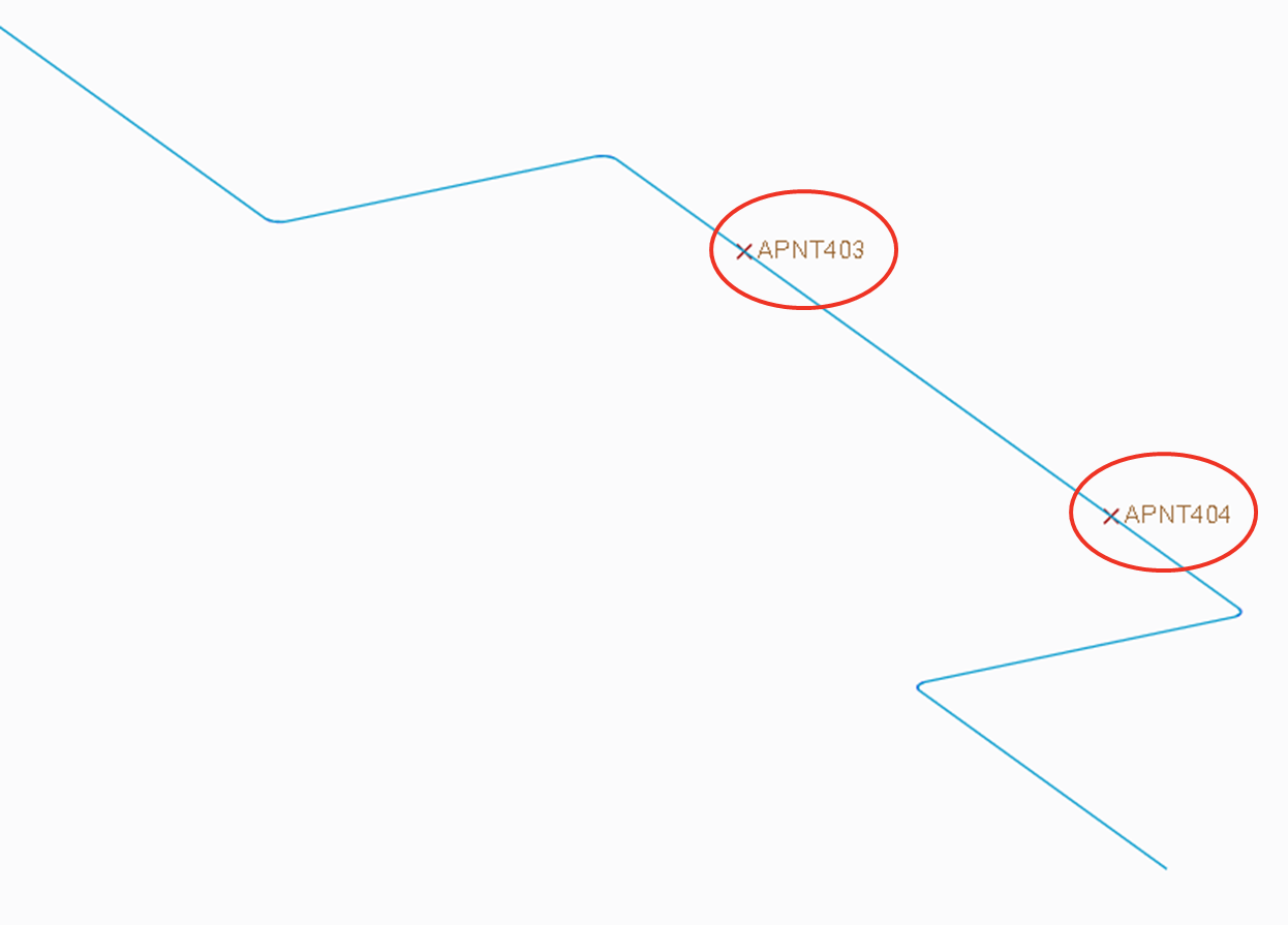

Step 1
Add 2 break points to the 120" segment, 24" from each end.
Step 2

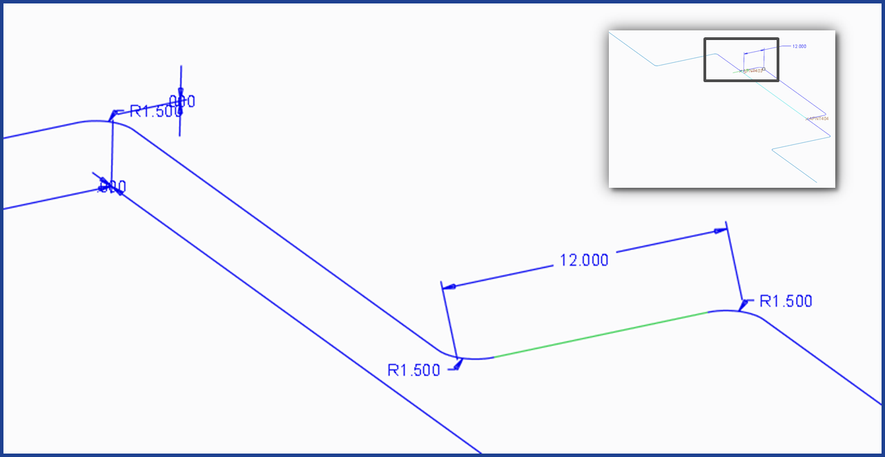

Use the Move Segment command to move the new segment by 12"
Step 3
After completing the command double click the 12" segment (what I referred to above as the "legs") created.  Notice there are no angular adjustments possible...only bend radius and the length can be adjusted.
Step 4
Try not to freak out when you realize there's no way to get that 12" segment to use bend angles other than 90 degrees
Does ANYONE know of a way to add an offset to an existing pipe segment that will allow you to adjust the angle of the legs?
