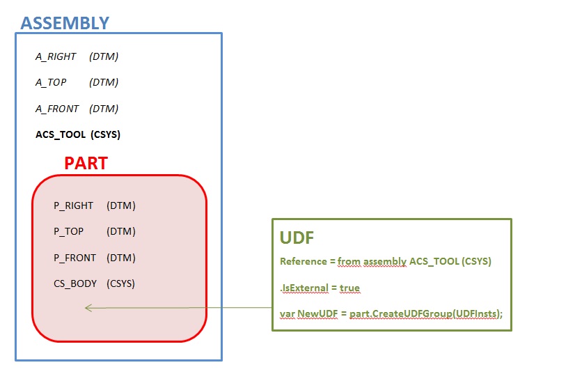

Hello PTC communtiy,
i need help according an issue using weblink/jlink for placing an udf in an part (with references from the assembly), which is an member of an assembly (root).
Everything works fine so far, i can place different udf's in the part using weblink.
But as soon as i want to edit the feature (after placing) i get an prompt that Pro/E is missing the external references.
How can i solve this issue? I have tried different things, but i still get the same failure all the time.
When i place the udf's direct in the assembly, everythings just fine and there is no "external references missing" prompt.
I have attatched a picture for you, to expalin the modell structure.
The weblink code is shown above
Thank you very much for any advices in advance.
Berst regards.
Markus
