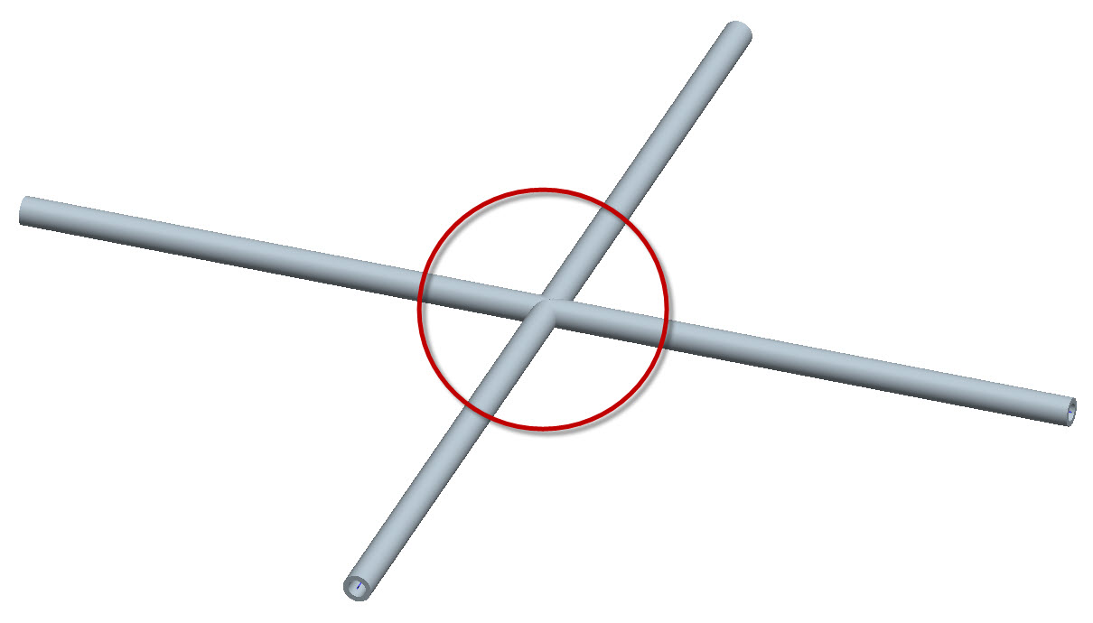

Fellow ProENGINEER/CREO users,
I'm having the following issue(s):
  • How to route a pipeline so that a proper 4-way branch connection is made?
  • How to place/configure a 4-way branch fitting in combination with spec-driven piping?
I've allready searched the entire (for as far as that is possible) PTC Knowledgebase and PTC help-files, there is however no documentation on how to even route a 4-way branch connection.
Examples/explanations that use non-spec driven piping are also of help!

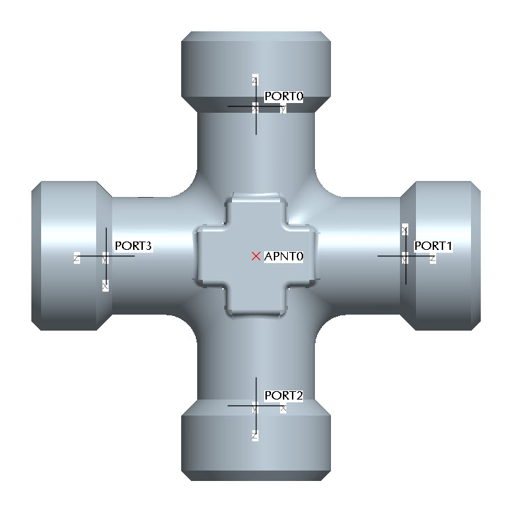

Some extra information about the fitting I used:
PORT0, PORT1, PORT2 and PORT3 coordinate systems are available. (I asume they are in the correct orientation/order)
PORT0 coordinate system has the following feature parameters:
  • SIZE = DN005
  • END_TYPE = WF
Component has the following parameter:
  • FITTING_CODE = BRANCH
These all correspond with the spec-driven piping configuration file parameters.
T-fittings (3-way branch fittings) work like a charm by the way.
July 31, 2014
Hi
I am sorry to say Spec piping does not currently support cross T's
Thanks, Jim
