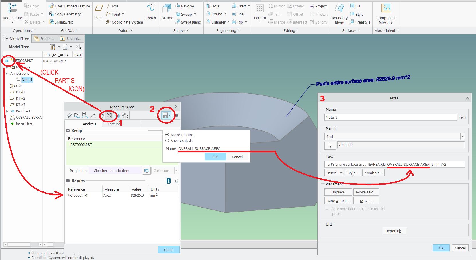

I am trying to show the surface of a part in a note .
To do so i tried to calculate the mass properties by going in to < File > <Prepare> <Model properties> and calculate the mass properties there.
Then in relations i defined a term "Surface_Area=PRO_MP_AREA"
After this in drawing i placed a note "&Surface_Area"
So i got the surface are of the part.
But now if i edit my part, the surface area in the note doesn't change accordingly in this method.
So please suggest a method by which if i edit my model, my values for surface area should also be changes automatically.

Best answer by psobejko
I think that your problem is that, by default, the built in PRO_MP_XXX parameters do not auto-update after regeneration.
You have to go into File->Prepare->Model Properties->Mass Properties (change)->Calculate... (or Generate Report...)
However, you can calculate the mass properties upon regeneration if you set the config.pro option:
mass_property_calculate automatic
(other options available, check configuration editor)
2nd point: you shouldn't have to make another parameter and equate it's value to that of PRO_MP_AREA.
Just use &PRO_MP_AREA directly in your note.
3rd point:
Since the behavior of your model's usage will vary depending on end-user's config.pro state,
I suggest you might want to utilize the measurement tool to create an area analysis feature and then display its calculated AREA parameter in your notes:
Notes:
1) the syntax to display the parameter AREA which belongs to a feature called OVERALL_SURFACE AREA is &AREA:FID_OVERALL_SURFACE_AREA
2) [.1] is a modification code to round the display of this parameter to 1 decimal place;
3) you'll notice that when you edit this note afterwards, the OVERALL_SURFACE_AREA will have been replaced by the feature id number.

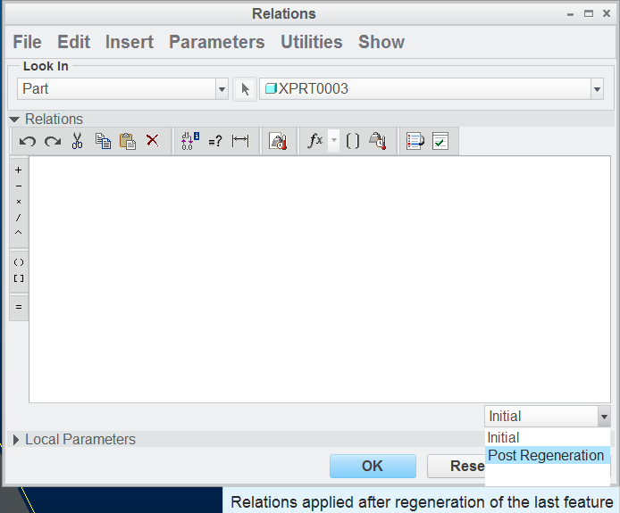

if you defined Initial relation then you have to regenerate your model twice.
Please upload your model and drawing for testing purposes, if it is possible. Use How to Attach a File to a Discussion Reply procedure.

August 2, 2016
you can define Post Regeneration relation instead of Initial.
