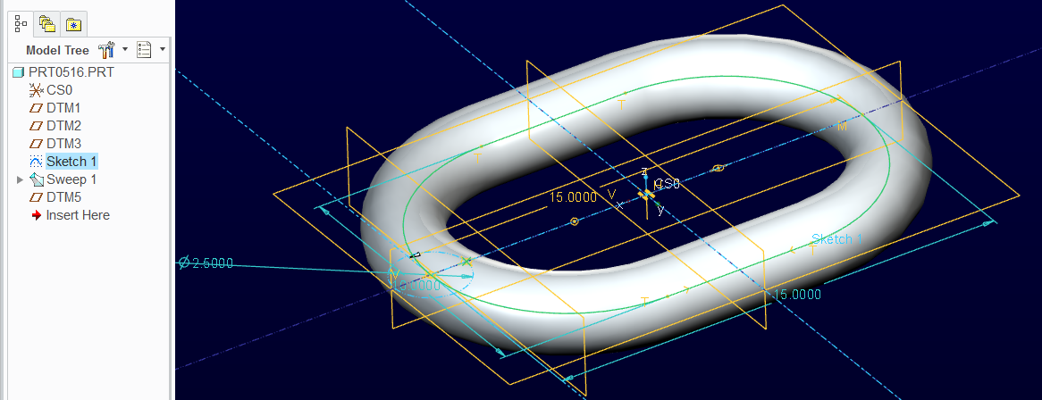

helo
i want to make a plan tangent to item at atached file
how i do this?
tank you

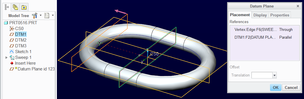

Best answer by TomD.inPDX
And as with all things Creo, another method is to have a divided arc on the sweep sketch. Run the sweep on the outside of the sweep profile. In this case, the plane is at the vertex of the sketch arc.

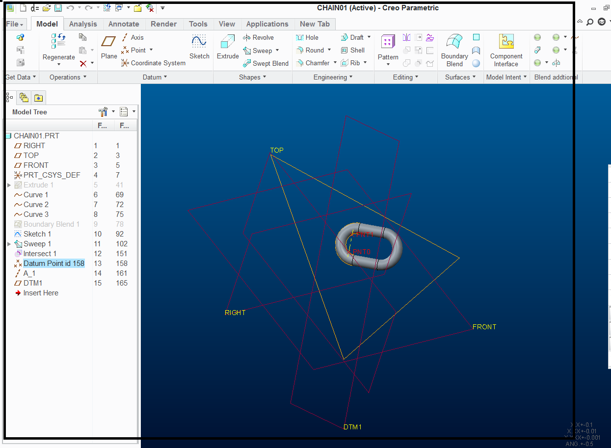

September 26, 2014
it is made: 2 points from both end, real value > axis >plane

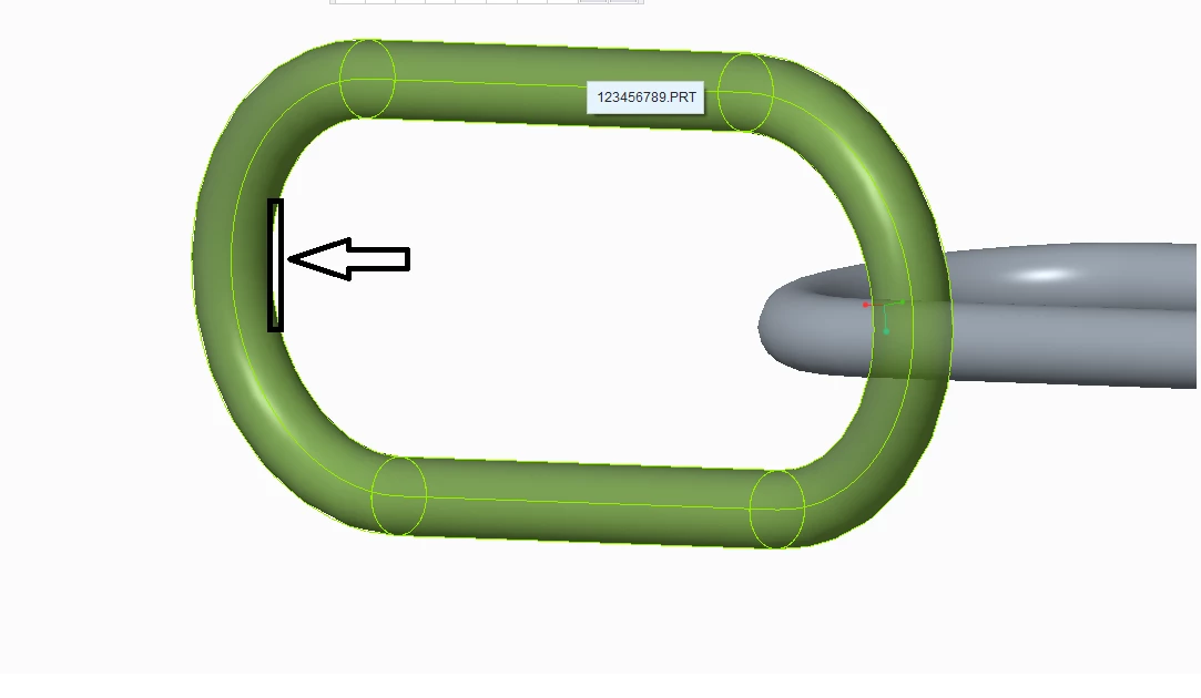

You will need to make some additional geometry to create that plane.
This example shows a geometry point offset from the sweep profile. You can use relations to manage the dimensions between the sweep profile sketch and the feature section.
September 26, 2014
