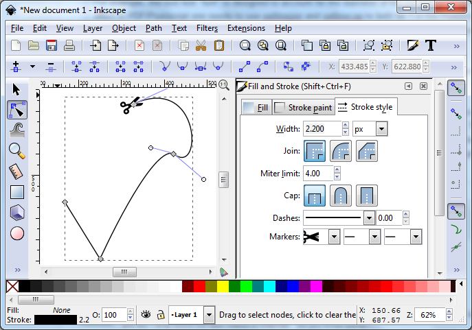

I also know PTC specifically decided to not include these options for the entities in Detail; there is no option to set line cap and line join types directly for detail items and have the results of those options show on the screen. This is unlike many other vector drawing tools, especially Postscript, but even the free tool Inkscape, as seen below. The Detail group also decided that displays of hidden line fonts should also have delayed evaluation, leaving it to the Plotting/visualization group, so the Detail user has no control over a crucial aspect of the final appearance of their product.
There's no /rant because it would continue on with the weak spline handling. In contrast, note the node-curvature handles in Inkscape. What is in the diagram is a single path  that has perfectly straight segments and curved segments. The scissors symbol is one of dozens available under the end-point marker selections. While I would not expect PTC to have that wide a variety, even simple arrowheads would help in creating certain symbols. And symbols are a whole separate rant.
