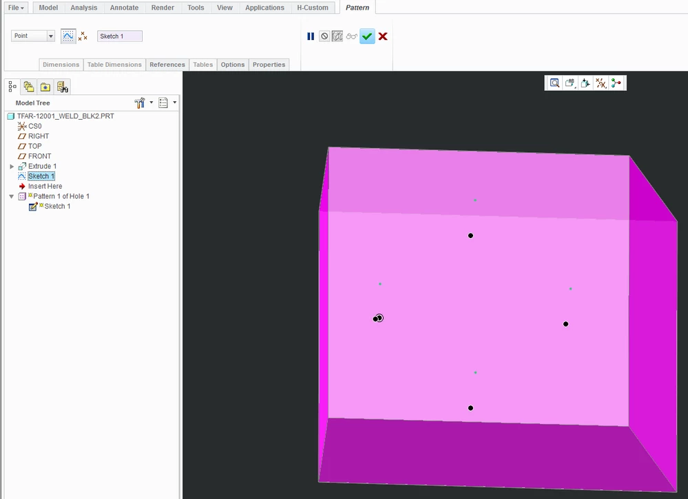

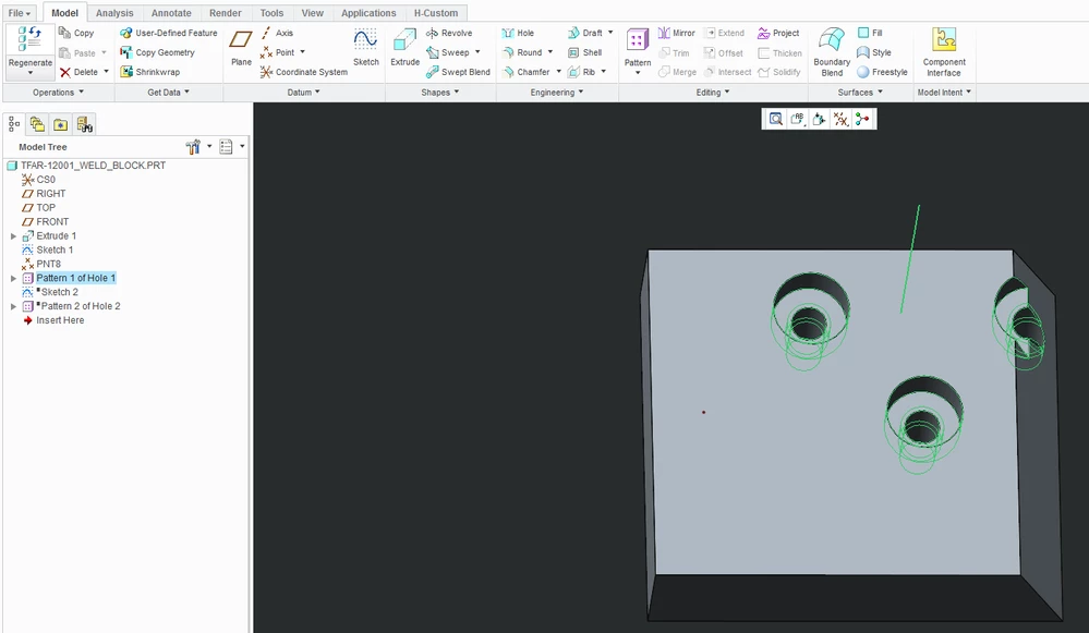

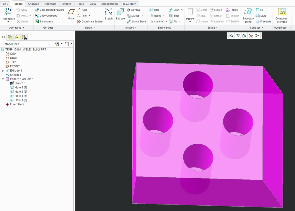

When I try to make a hole point pattern from a sketch it works fine. But when I try to make threaded holes, creo adds a new hole that is out of position with my sketched points.  Is there any way to fix this?

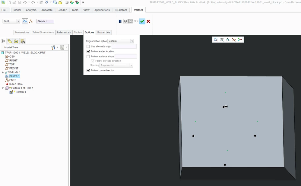

You have to use the "Use alternate origin" option in the Options tab of the sketched point pattern.
There, specify the point in the sketch that corresponds to the pattern leader.

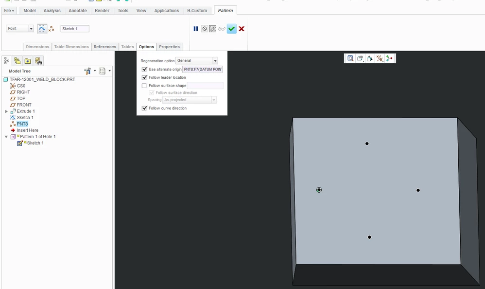

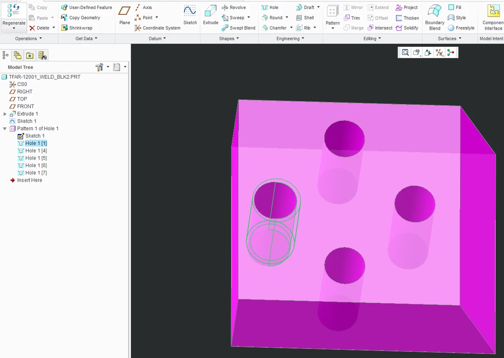

I tried using alternate origin, but It doesnt let me select points on the sketch. When I try to select a vertix, it shifts the pattern off of the proper position. I then made a point on the same position as one of the points in the sketch and used that as an alternate starting position and it still shifted the pattern.
September 18, 2017
Try activating the "Use Alternate Origin" input box, then pressing CTRL+F; search for points.  Then select the correct one from the list.  This should work, but then again, I don't have your model - can you attach it to your next post?
