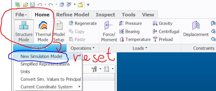

June 22, 2017
You can reset/clean:
regards
paul
