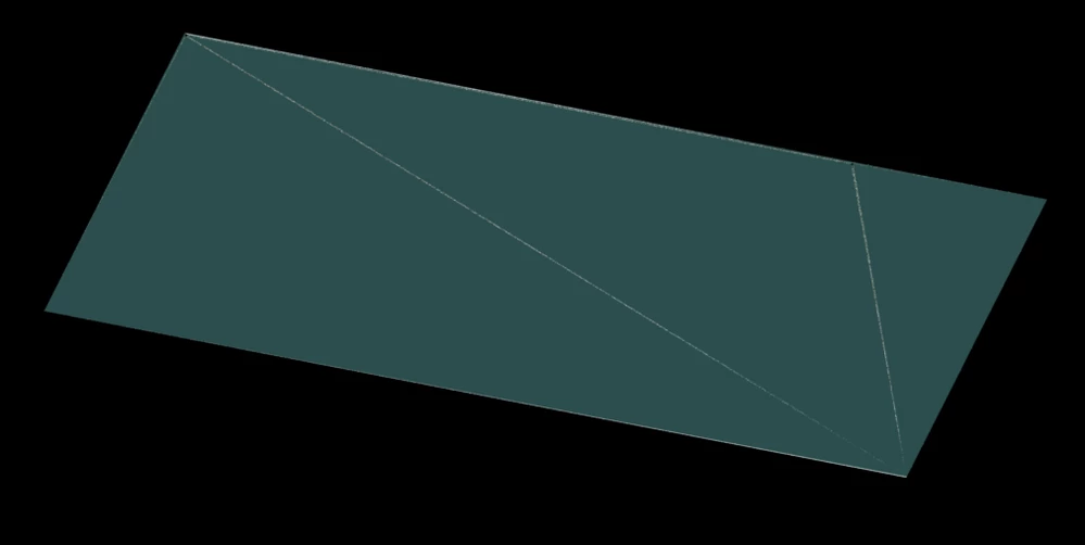

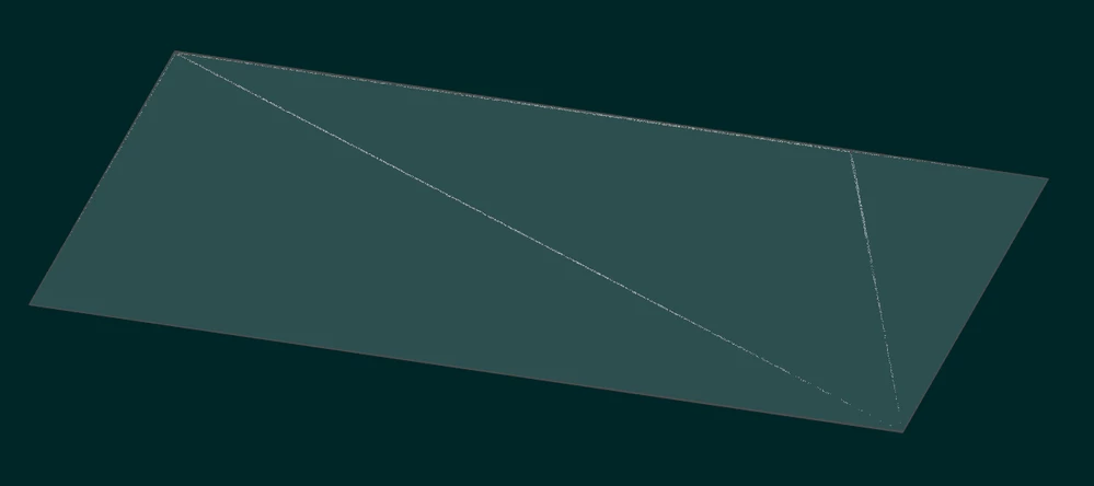

I am having problems taking screenshots of high-accuracy model of "thin sheets".  They are just not presented properly in Creo 2.0:
as viewed in the part modeling modeas viewed in the part modeling modeas renderedas rendered
The pictures pretty much say it all.  AFAIK, I have all graphics settings maxed out (shade quality 30, smoothed edges, shade small surfaces on, antialiasing at 16X, ...) - but still these visual artifacts persist.  I wonder if this is the best I can do with Creo 2.0, and did things get better in Creo 4.0 / 5.0 ?

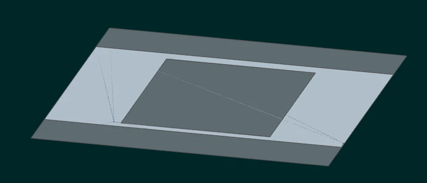

yeah, try this one please and see if you see what I see:
I can see that if I get rid of the holes, these "facet" lines disappear, but I am wondering if such a hack is my only option.  I was hoping for an option I can toggle to force creo to "render all surfaces"
September 13, 2018
Yes, I'm seeing the same thing.  Interestingly it only happens on the front side.  The back side doesn't do it.
The root cause seems to be the small gaps between the layers.  If A_, B_, and C_ are set to zero, the graphics anomalies disappear.

September 14, 2018
Here's what PTC had to say:
The lines that are displayed at further zoom levels from the circles is a result of z-fighting. The color from the behind surfaces is bleeding over the front surface. Unfortunately, the only way to prevent this is to use the same color for both surfaces.  Higher Anti-Aliasing values reduced the color bleeding but did not remove it completely.
A quick Google search leads to this Wikipedia page:  https://en.wikipedia.org/wiki/Z-fighting
