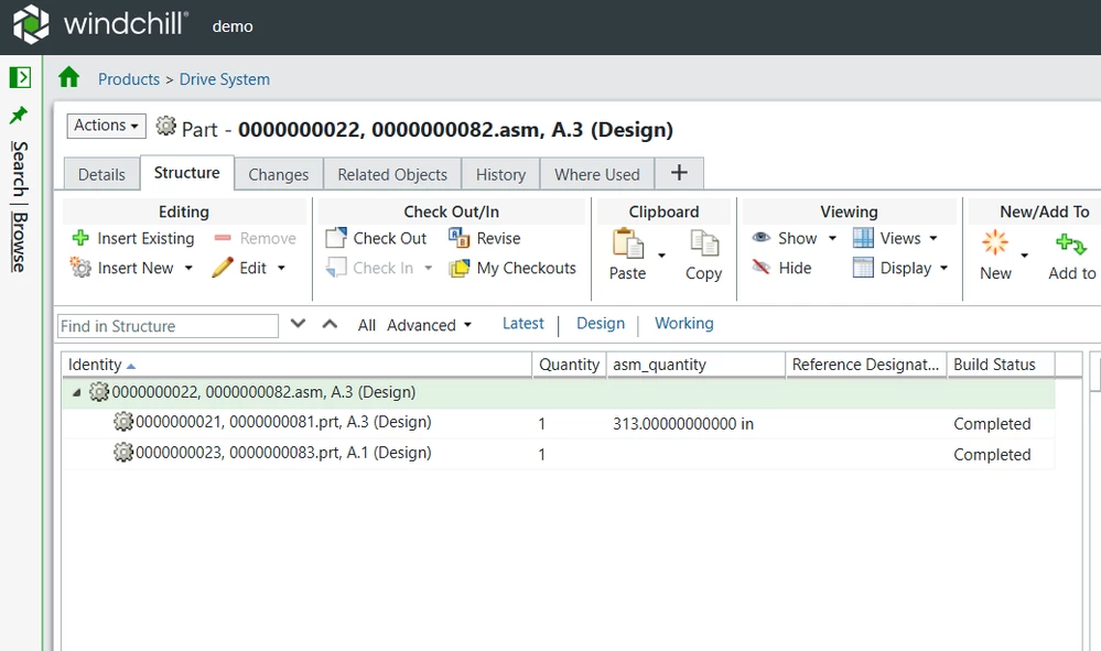

Yashraj_R
Dec 18, 2025 1:39 PM UTC
Or you could try something like-
add an assembly driven attribute asm_qunitity
looks something like-
by-
Not sure how ERP will handle it though, that part needs to be checked
Also note- I created the attribute as "Real number with units" to have both mentioned in the same box
could be helpful

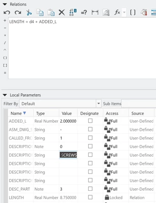

I haven't used windchill in a while. But my two cents are having a part name reflect a part length is a waste of time, name it after it's location or something.
I'm fairly sure that windchill can accept parameters. I don't know if that can be used in quantity the way your system is set up. If not it may be worth handling cut to length parts differently where the quantity is bulk and there's a length parameter.
I associate all pipes to length in notes/ parameters there's different ways to do it. Since you may have curves which complicate automatically accounting for the length there could be an ADDED_L parameter to add to the first straight length like so.
