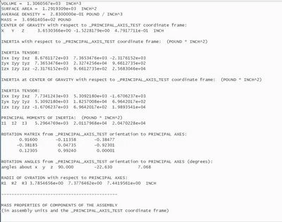

I have a mass system that I am designing isolators for.  I'm attempting to create a new coordinate system that represents the principal axes so that I can use that to identify locations and angles for the isolators.  My problem is that when I compute the principal axes, then create a new coordinate system at the location and orientation of the reported principal axes, the location is correct but the rotation is slightly askew and I can't figure out why.  In the picture below, I would expect my 1, 2, 3 axes and X, Y, Z to be on top of each other.  I uploaded the CAD files as well.

I have had trouble when translating and rotating coord sys in one csys. I will break it up in to translation for a 1st csys and a 2nd csys for rotation.
Not sure if this will help you or not.
Thanks, I tried that but still  got the same results with the axes slightly askew.
tbraxton
tbraxton22-Sapphire IIAnswer
That did it!  Thank you very much!  Rotating about a newly created axis makes a big difference of how the coordinate system ends up.
