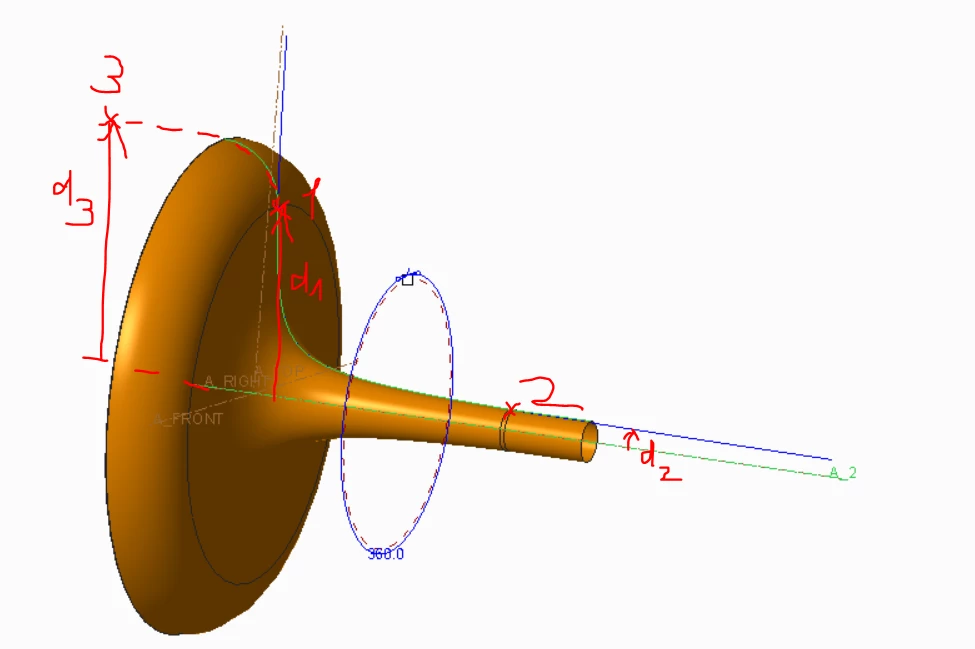

Hi!
Basically i used these equations for the hyperbola:
x =1*t
y =0
z =a/(1*(t))+r
r=d*0.35

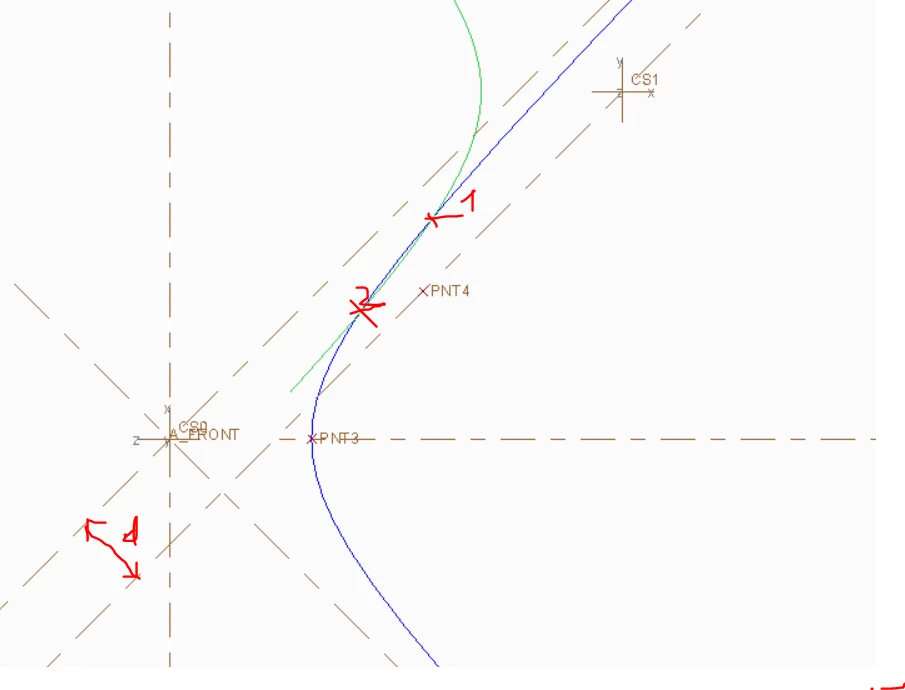

As i see it's better to use the equations u wrote. with it i can define the distance from origin as you told. But the problem is that then i would like to make the other hypebola tangential with the first one. (Se thhe picture below) I defined the first hyperbola in CS0 and then with a given distance from the tangential line of the first hyperbola i defined CS1, in this coordinate system the second hyperbola.. but the problem an Point 1 and 2 these are not tangential. How would it be possible to make these two at around P4 tangential?
Here i used these equations for both hyperbola, because it is no problem if they are the same:
 y=0
x=A*sinh(t)
z=-A*cosh(t)
Thanks!!
