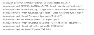

I am going back to the previous mapkey:

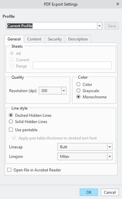

The issue I am having is that after I change the PDF Export Setting by selecting the "Options" button and selecting the correct setting name.
I then update the name to be exported and hit enter.
The "PDF Export Settings" window pops up and the cell containing the name of the current profile is activated instead of the "OK" button.

That is also why I went back to:
File - Save As; Drop down - select "PDF (*.pdf)
Click "Options..."
Select my "PDF Export Settings"
Click "OK"
[For my company add a proceeding "v"]
Hit "Enter"

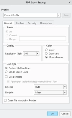

I record that for a mapkey but when I run the mapkey the current profile line is "active" instead of the "OK" button. I have to "Shift-Tab" twice to switch the "OK" button to be active.
