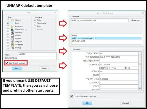

I am trying to set up some default parameters, Tools; Parameters, for when I start a new part I dont have to add the parameters each time. I've searched on how but I don't think I am using the correct terminology.
Also I have seen setups where when you start a new drawing a popup box will come up so you can enter information in for certain parameters, does anyone know that command?
Thanks.
Best answer by vmráz
But it´s highly recommended use default templates. Mainly if your project aren´t one man show ... If you work in team keep the motto: It´s not important if we are working well or bad (wel is better ), but MAINLY ALL THE SAME. Than you can keep orientation in work of other team members...

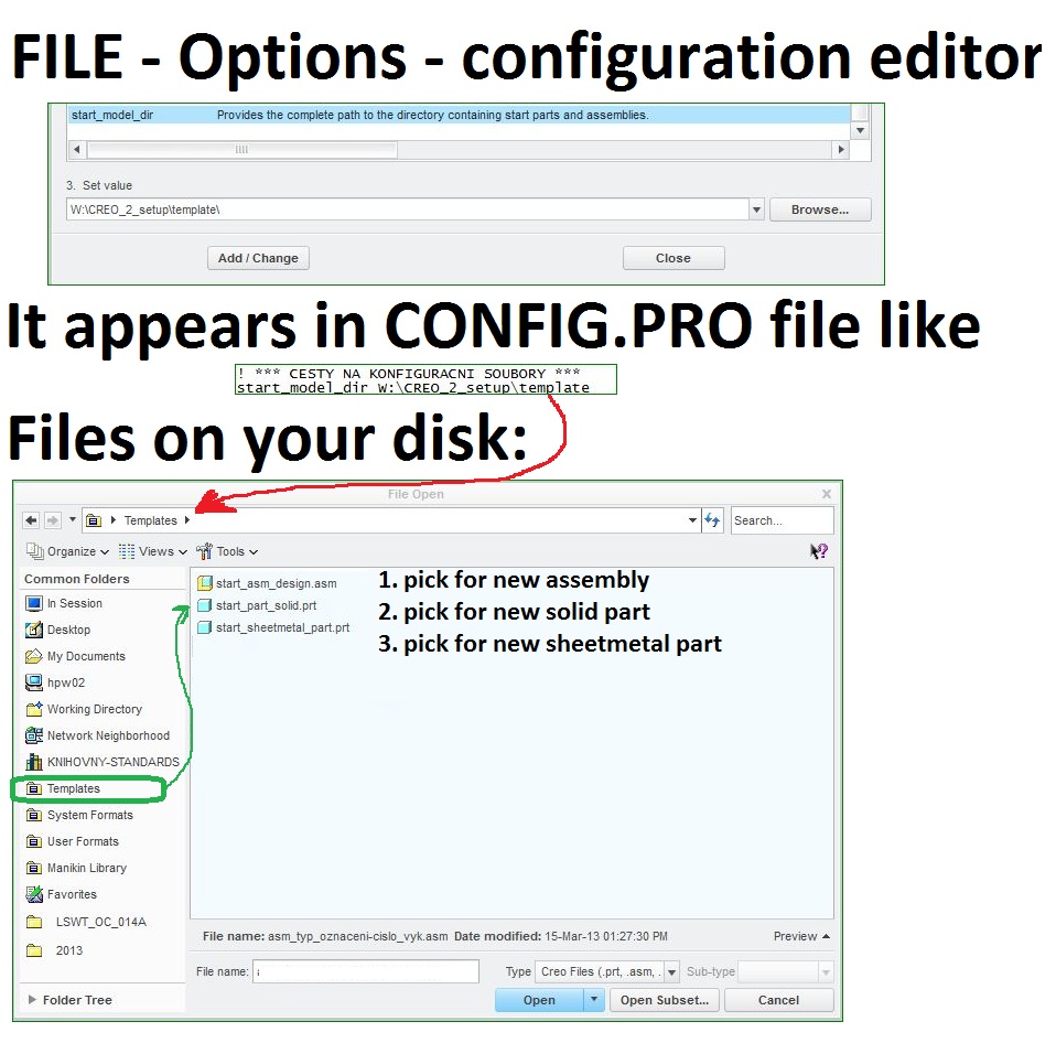

Part 1 is fairly easy but still requires a comprehensive look at your business practice.
The idea is that you have a custom config.pro file in the startup folder for Creo. Simply put, your desktop shortcut has a start-in folder defined and that folder has your specific config.pro file which is to be read for the session being opened. You also have the option within the config.pro to set a custom detailing file with similar config setting for drawings or 3D annotation. You want to manage these special files outside of the install folders of Creo.

You need to setup your START PARTS. In generall it is start solid part, sheetmetal part or assembly that you need for creating of new components. All default data are loaded from this parts when you create a new one.
July 1, 2013
Second part of your question:
vmráz12-AmethystAnswer
July 1, 2013
