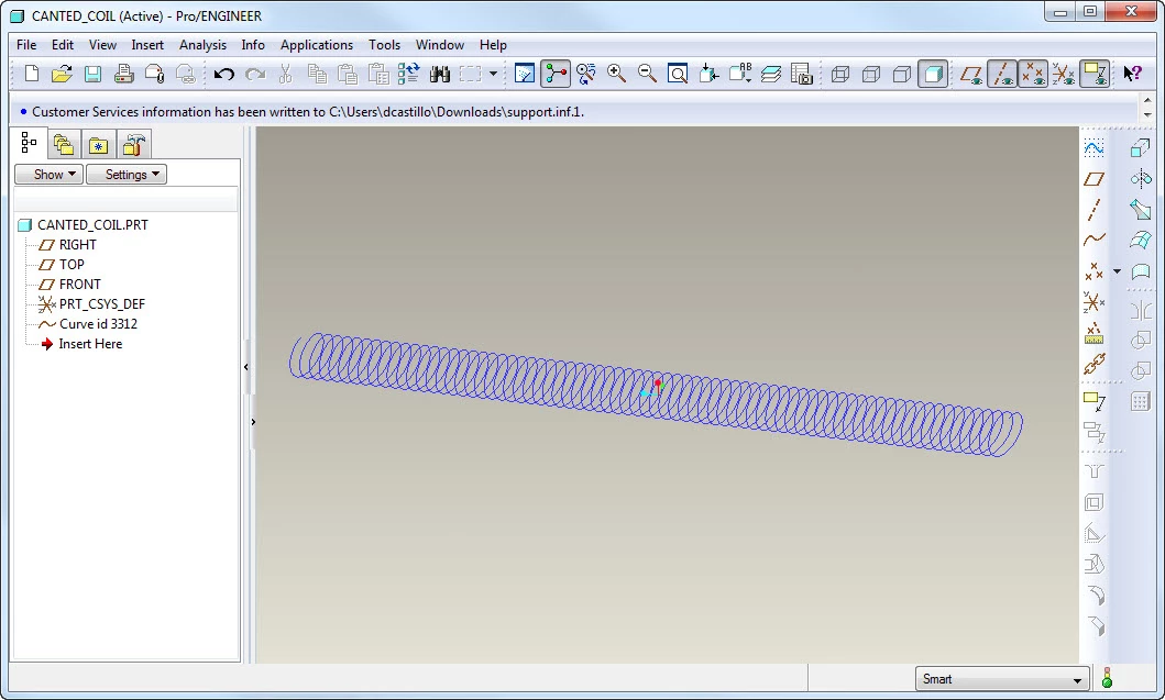

May 8, 2013
OK,
You are freaking me out right now. I downloaded your part and opened it. It opened Wildfire 4.0 M220 and I can see it just fine. There is only one little problem.
I don't have Wildfire installed on my system. I run Creo 2.0 and there is no other version of Creo or Pro/ENGINEER installed anywhere.
How did this part launch Wildfire 4 M220 on my computer when I don't have the install for this version anywhere to be found?
Totally confused. I attached a screen shot to prove it. I don't have Wildfire installed anywhere.

On 05/08/13 10:18, Damian Castillo wrote:
> OK,
Select
Help | System Information
and then look for the installation directory. This will tell you where the ProE is started from.

Mistery solved.
It appears that I installed Wildfire 4 a long time ago as a test and
forgot about it. I run 64 bit versions of Creo 2 and the old installation
was in the "Program Files (x86)" folder. It was not showing up in the
Add/Remove list either. The other weird thing is that the install folder
was "proengineerwildfire" which I don't remember ever using. I normally
install under PTC folder.
I only run Network installs, so this added to the confusion even further.
I finally did track down an old local install of WF4 on my system and
just removed it.
When I double click a part, it's setup to open in Creo View Express but
for some reason, this particular model ignored that rule and found an old
wildfire install to open it.
In the end, you helped clean out my computer so thanks. ROFL
