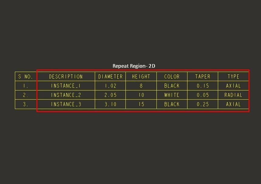

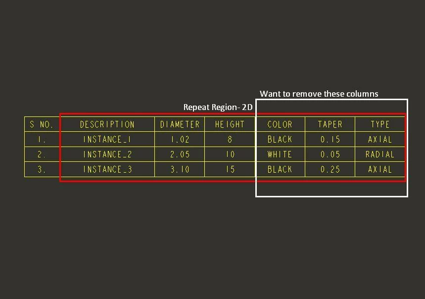

I have some query regarding the deletion of some columns which I have
created by 2D repeat region command; I still need those in the family
table of my part file. Is it possible? Plus is it possible to rename the
headings (&fam.inst.param.name) in the drawing files itself?
2D Repeat Region (general format):
&fam.inst.name
&fam.inst.param.value
Will be waiting for your reply...

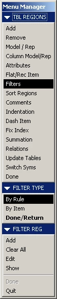

You will need to use the rule filter
Add these relations and they will not be shown
&fam.inst.parm.name != color
&fam.inst.parm.name != taper
&fam.inst.parm.name != type
