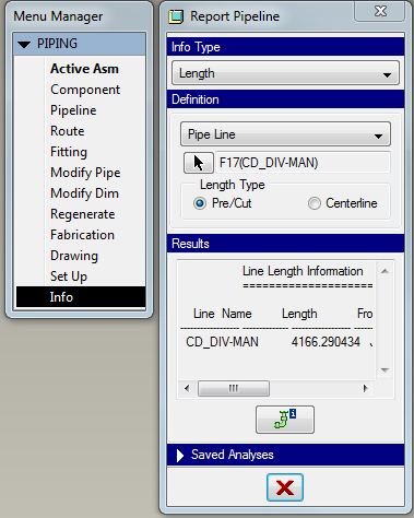

Best answer by rustys
while in piping.... click info/ set type to length and pro/e will display the overall length of the routing.
i have large assemblies with dozens of routings and when i need the lengths i use a repeat region table and then export it to excel to create drawings.

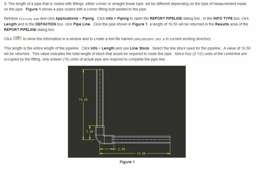

Erin,
See the attached picture.
Greg

rustys1-VisitorAnswer
September 26, 2012
