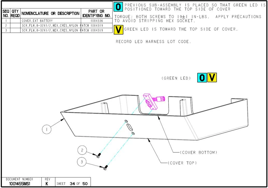

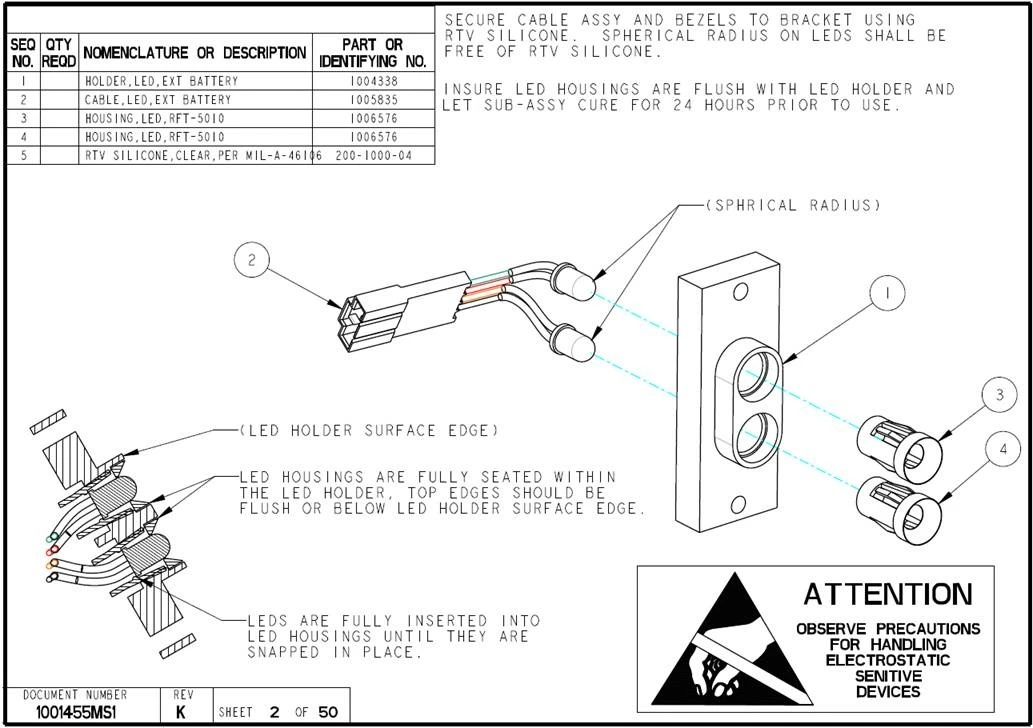

One method that I've used it is to create the step where the components
are bonded together and show up in the assembly sequence steps (BOM),
apply a note for them to be set aside until adhesive is cured. Then
create a simplified rep excluding this bonded sub-assembly for the
following steps until this sub-assembly is consumed. Then later when
this subassembly is consumed use a different simplified rep that shows
them. It really help if you use the previous assembled component color
configuration setting so that in the step that this sub-assembly is
consumed the operators can clearly see that it is not a component
missing in that particular step of assembly sequences (BOM). I use
magenta in this sample whre they are bonded on page 2 but not assembled
until page 34.
Thank you, Jim Flores
