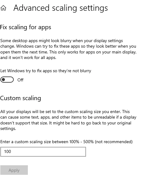

July 9, 2019
I had same issue.
I fixed in this way
Right click - Display Settings - Advance scaling settings
Turn off "Let Windows try to fix Apps so they're not blurry"
Change scaling to a custom (try first with 100%)
