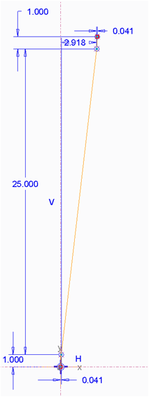

The datum graph that I used is shown below:
The X-Axis is distance along the spring, and the Y-Axis is number of turns. The spring that I am using is 3 inches in length, has a wire diameter of 0.041 inches and has 27 turns. The spring is closed so the first and last turn each use one wire diameter (0.041 inches) of the length of the spring, while the other 25 turns take up the rest of the spring's length (2.918 inches).
I create the foundation of the spring's geometry by sweeping a line around a trajectory. To spin the swept line around the trajectory I feed (trajpar * spring_length) into the datum graph to calculate what turn I am on, which I multiply by 360 degrees to get the angle of the line (which is sd5). The relation is shown below:
number_of_turns = evalgraph('SPRING_TURN_NUMBER', trajpar*spring_length)
sd5 = number_of_turns * 360

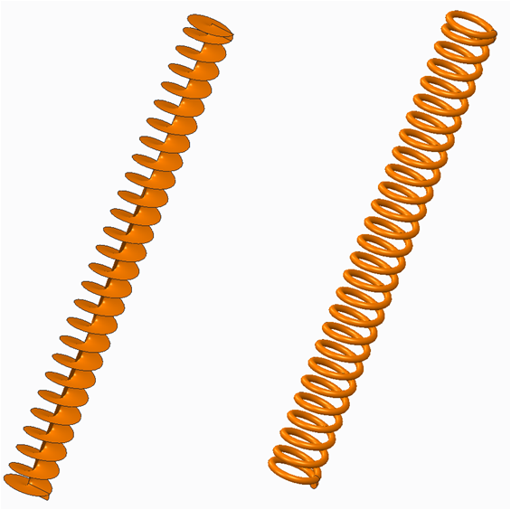

The result initially looks great (swept feature on left, and the final spring geometry on the right):

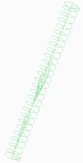

If I highlight the the swept surface (the image on the left above) I see some really funny stuff going on:
Can anyone tell me what is going on here? The crazy going on along the axis of the spring shouldn't be there. Is this harmless visual junk that Creo is spitting out, or a symptom of an underlying problem with my relations in the Variable Section Sweep.

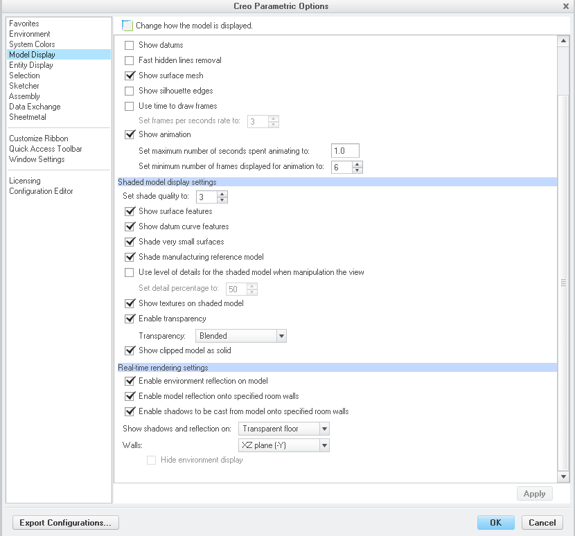

It looks like visual junk that Creo is creating when you select the object. I would start with looking at your model display settings. Maybe something in there will fix the issue. It could also be a graphics card issue. Of course it just may be that because of the way the part was made this is how Creo sees the part.

And the way you keep the VSS from creating the artifacts, try making the line you sweep only half the line as geometry, and the other (center) half construction; both equal lengths. That avoids creating geometry at the axis.
knorman1-VisitorAuthor
May 19, 2014
This did the trick, thanks for the advice. I can now sleep at night

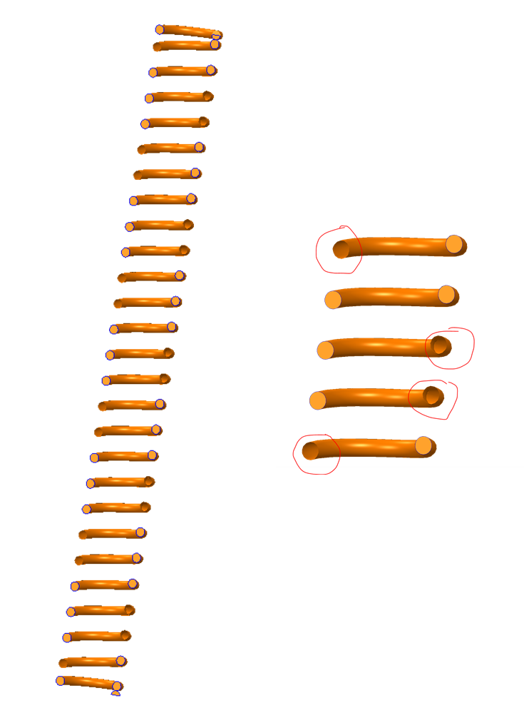

I know this thread has been dormant for a while, but I got distracted on a different project. I just came across some interesting behavior with the spring in when making a drawing (image that…) when creating a section view that I think is important to add to this thread.
There were two different methods for creating a spring shown in this thread:
  • My method of using a VSS driven from a datum graph
  • TomD’s method of using the wrap feature
I was able to model the spring using both techniques. Since I already had the spring modeled with my method in my assembly and correctly functioning as a flexible part, I decided to continue with my version of the spring. I needed to make a drawing of the assembly which required a section view. As it turns out, I couldn’t create the section view on the drawing. I kept getting: Cross-section created in view “new_view_#”, on sheet #, aborted.
When looking at the section view of the assembly in 3D, I found some interesting issues with the geometry with my version of the spring. Some of the ends were not capped.
I think this has something to do with the drawing section failure. I even tried to sweep a circular surface with the ends capped (making a hollow spring) and solidifying that part with no luck. I also found that importing spring geometry from a STEP file had this problem.
Springs modeled with the wrap feature don’t seem to have this section issue. Helical sweep parts are fine as well.
I can’t say that VSS springs will always have this problem, or that springs made with the wrap or helical sweep methods will always work (maybe someone here knows what is going on). I can say that I will be using the wrap method from here on out. In my limited spring modeling experience it is more stable and, and after a few times using it, more intuitive to use.
