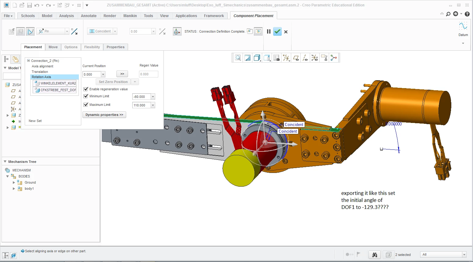

I would be really grateful if you can help me with this issue:
I assembled the parts of an exoskeleton for upper limb from my master thesis. It has 3 degrees of freedom modelled with a mechanical pin connection in creo parametric. regenerating the assembly and exporting it with the Simscape export link to Simulink works fin!! The only problem is the the initial value for the angle is set randomly. I tried to define the intial value of the angle in the placement-->rotation axes menu in creo. But when I export the assembly the initial angle value (not the position itself) is changed
would be great if someone knows a solution
thank!
Marco

In mechanism there is a regen value that can be set.  Use of this function should be the easiest way to return to a known state.
However, diligent use of snapshots can also get you to predefined conditions.  It is hard to keep up with since every change can disconnect mechanism and fail snapshots.  But if it is iportant, there are options.
