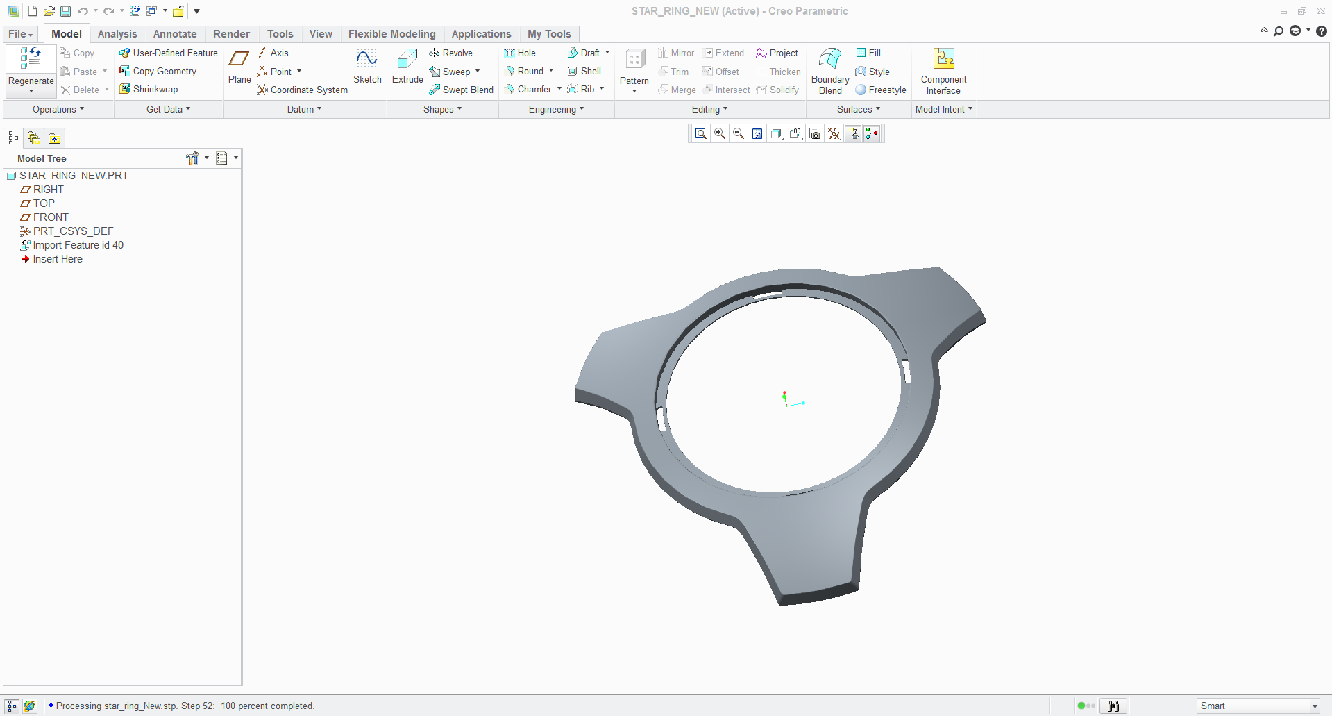

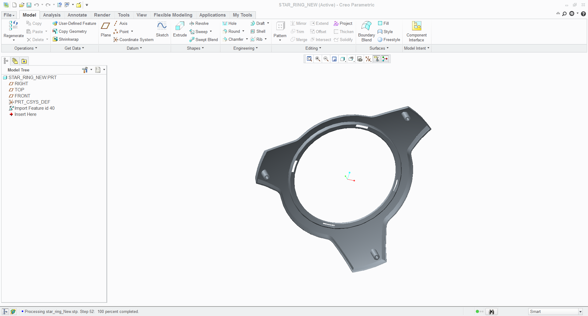

Is it possible to generate Core & Cavity(Volume Split) for this component in Creo Parametric using Tool Design Option?
I've tried me level best, but was not able to creat the parting surface for this component.

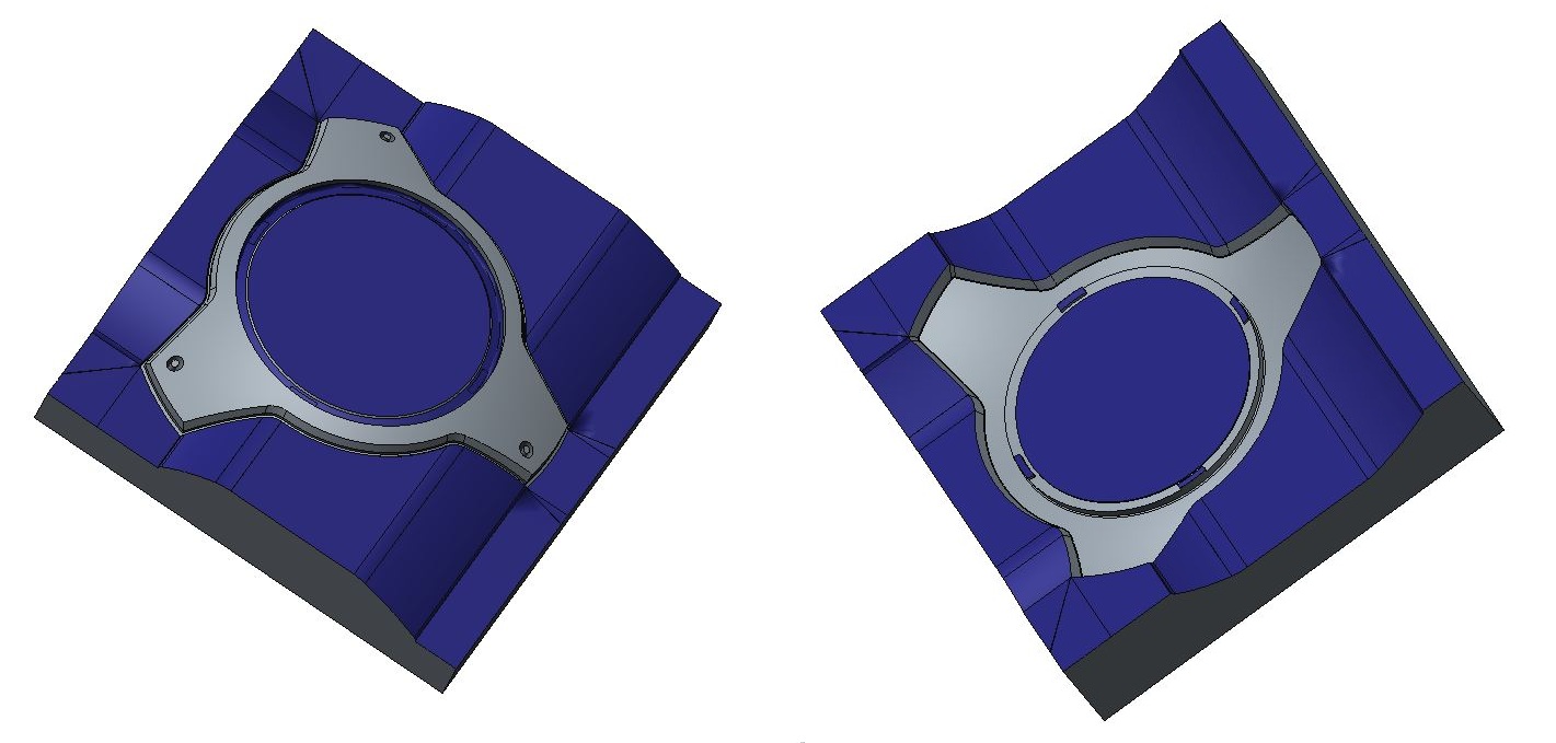

Best answer by James62
Ok here you go.
It looks kinda messy in 4 of the corners but not too bad for starters.
Click on the image to make it larger.

I'm evaluating Creo TDO on Creo Parametric 2.0 this month. I've failed to make automatic parting surfaces for this and several other parts today.
I'll try to play with this one again later. Didn't have a chance to spend enough time on it yet.
James621-VisitorAnswer
October 29, 2012
Ok here you go.
ssharma-21-VisitorAuthor
October 30, 2012
Hi Jakub,
Awsome job..
i'll be very thankful if you could please upload the core cavity assembly as well...
Shashank
October 30, 2012
hi,
It's not gonna upload. Guess it's too big.
Check your pm.
~Jakub
