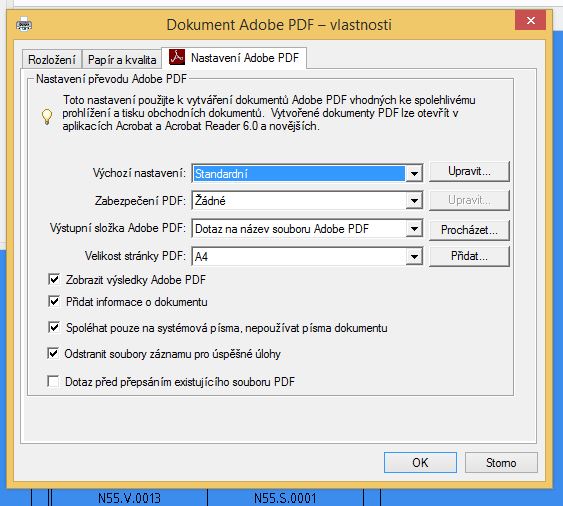

April 16, 2014
Did you pick right paper size in pdf options? Like A4, A3...?
April 16, 2014
It doesn't show that option
