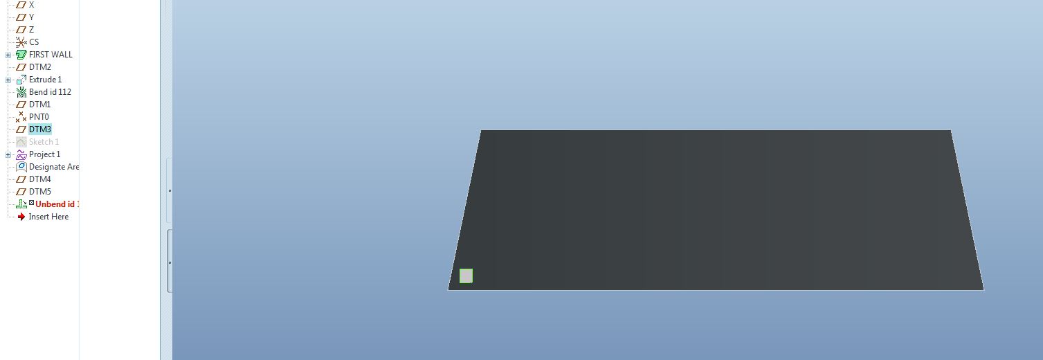

Hi all,
I'm having a few issues regarding unbending a rolled sheetmetal part. I can unbend the part no problem when there is no extrudes at the sides. Now when I try to unbend I cant pick a reference edge or plane. I have created different planes to pick as a reference edge but to no avail.
Anyone have any experience of this? Help much appreciated.

Transitional roll and changed accuracy and it worked.
Rik.
