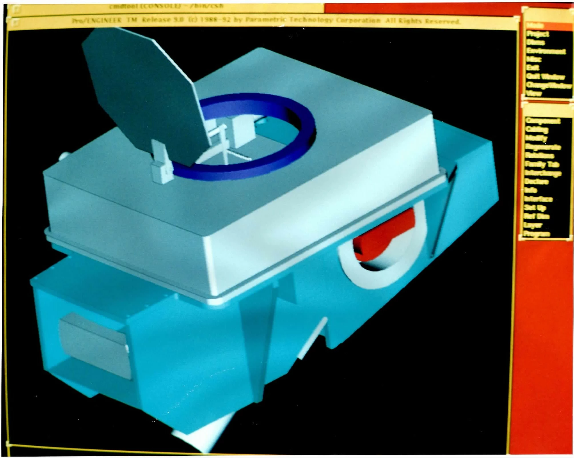

Thought this might be interesting for all to see a picture of a screen shot ( with film!) of what
vs.3.0 looked like. This is 1992, of an instrument I designed while at Caltech. I started with vs 1.9 in Feb 1988
with a Sun 360, Unix and 19" monitor, ~ $30K for hardware. As I remember, a global interference check took some 20 minutes(:o).
It saved my b--- then and many times since then.
I have another 1992 picture of an instrument called Low Resolution Imaging Spect (LRIS) at Keck Obs.
Anyway, thought this might be interesting.
MICHAEL

May 13, 2011
Olaf has a video of rev. 1 on www.proesite.com<">http://www.proesite.com> under the miscellaneous link. It's very similar to rev 15/16 that I started on.
