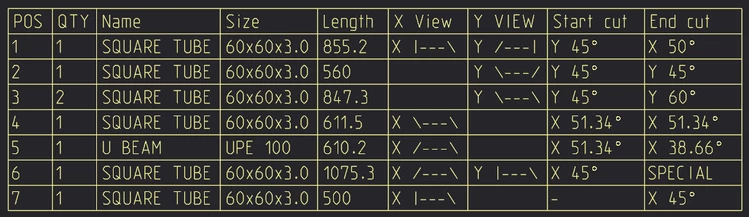

Hi @MaikTheBike ,
I just wrote a blogpost about this here: https://www.buw-soft.de/en/2019/08/08/cut-angle-information-in-bom-parameters/
You can download the attachment and follow the instructions in the readme.

Thanks a lot.
I've downloaded the table-files and it works very well. The cut angles are displayed correctly.

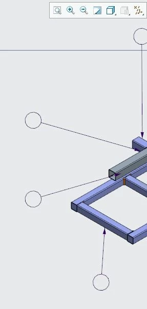

Only one thing doesn't seem to work: The first column of the table(asm.mbr.EXF_ITEM_NUMBER) is empty. What do I have to do to get this parameter into the part ?
When I create balloons it looks like this (without numbers in the balloons:
So what can I do ?
Maik

If you want to use the creo standard you can set the repeat region parameter to rpt.index
