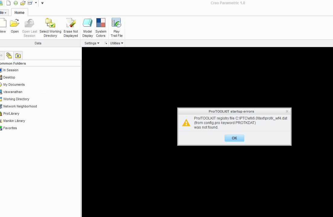

I prepared a new configuration.pro for new project, i am facing the new error while opening creo/elements pro 5.0.
I have attached some screen shots below, Kindly view it and help me.
1.while startup showing this error
Actually it says misssing some protk file,
We are using creo/elements pro 5.0 and with inbuild EFX 7.0.
Please give me a solution and define what's the problem.

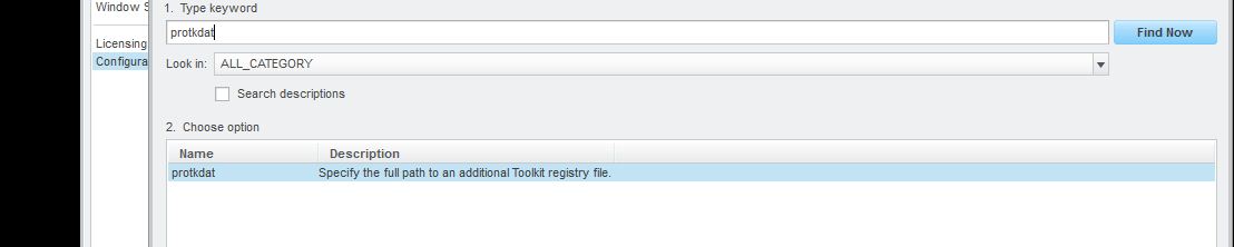

The config.pro option was one that someone had created or provided in the startup folder when you had WF4 on the system. Somewhere along the timelines of the updates, the location and the toolkit dat file was deleted. By removing the option from config.pro, the toolkit will look at the default toolkit dat information provided by PTC.
Not knowing what was in the original dat file, it is difficult to know what the difference will be. You might want to have a conversation with an administrator to find out what was special about the WF4 installation with regard to ProToolkit.

if you want to use proe 5 then efx 7 separately to be installed. I have faced the problem, al you need to go to that file, open with text editor and change the path for right file of wf5. For creo 2 it is now advanced assembly extension, u need not to install seprately.

And i searched the file protk_wf4.dat and protk_wf5.dat is not available
Please tell how to proceed furthuer.

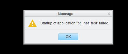

forget to attach this image on discussion starting

What if you remove the option "protkdat" from config.pro?

I think all you really need in your config.pro is:
efx_enabled yes
I haven't had to use the protk line to start up EFX since WF3. So I think Antonius' solution to just remove it was the right one.
Are you having any other startup issues? I got your email and I'm just trying to make sure you're on the right track. There's not much difference between WF3 and WF4 so your config.pro should be okay except for minor issues like the one you mentioned.
Even if you do see some weird error messages, chances are it will not impact you ability to work in Pro/ENGINEER successfully. If you see anything else, please let us know.
