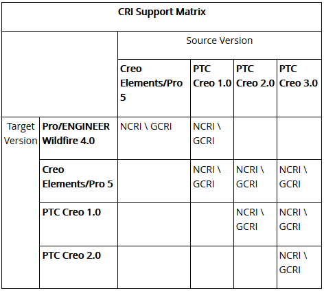

In the first link you sent there is table like this for "Granite Cross Release Interopera
Since there is no entry for the case of Creo 3.0 source to Wildfire 4.0, does this mean that GCRI does not work in this case ?
March 9, 2017
I am sorry, I do not know all GCRI rules. You have to try this functionality by yourself .
See also http://support.ptc.com/WCMS/files/166286/en/GCRI.pdf

March 9, 2017
Thanks to everyone who replied and for the useful information.
My conclusion is that it is not readily possible to export prt files from Creo Parametric 3.0 or 4.0 to Wildfire 4.  I have reverted to exchanging data with the other party (a machine shop) using STEP files which does work (without the parametric information of course) but that is good enough for my present needs.
