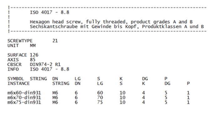

Save and close myfasteners.mnu. Edit legacy_fasteners.dat to match the file below:

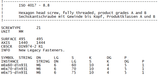

Save legacy_fasteners.dat but do not close it. The legacy_fasteners.dat file requires the surface ID and axis ID of the fasteners. Perform the following steps to identify the IDs: First, open m6x60-din931.prt. In the graphics window, move the pointer over the axis and note the ID 1440. Similarly, move the pointer over the fastener head and note the ID 495. Lastly, open and then obtain the surface and axis IDs for parts m6x70-din931.prt and m6x75-din931.prt. Type the unique surface IDs and axis IDs in legacy_fasteners.dat: SURFACE 495 495 and AXIS 1440 1444.
In Windows Explorer, from the <creo loadpoint> click Common Filesafx , configuration.  Then, in the Configuration folder, open sl_data.cfg. Review the section COUNTERBOREDIAMETER FOR SCREW'S to validate if the CBSCR is suitable for m6 fasteners. After validation, you can close the file. In legacy_fastners.dat, change the tooltip INFO from ISO 4017 - 8.8 to New Legacy Fasteners. Your file should match the file below:

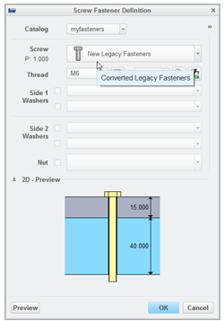

Save and close screws.mnu. Restart PTC Creo Parametric and open ifx_migration.asm. Using PTC Creo Intelligent Fastener, select the references to place a new fastener. When the Screw Fastener Definition dialog opens, note the following changes: myfasteners is available in the Catalog list and the tooltip is My Fasteners Library. New Legacy Fasteners is available in the Screw list and the tooltip is Converted Legacy Fasteners.
