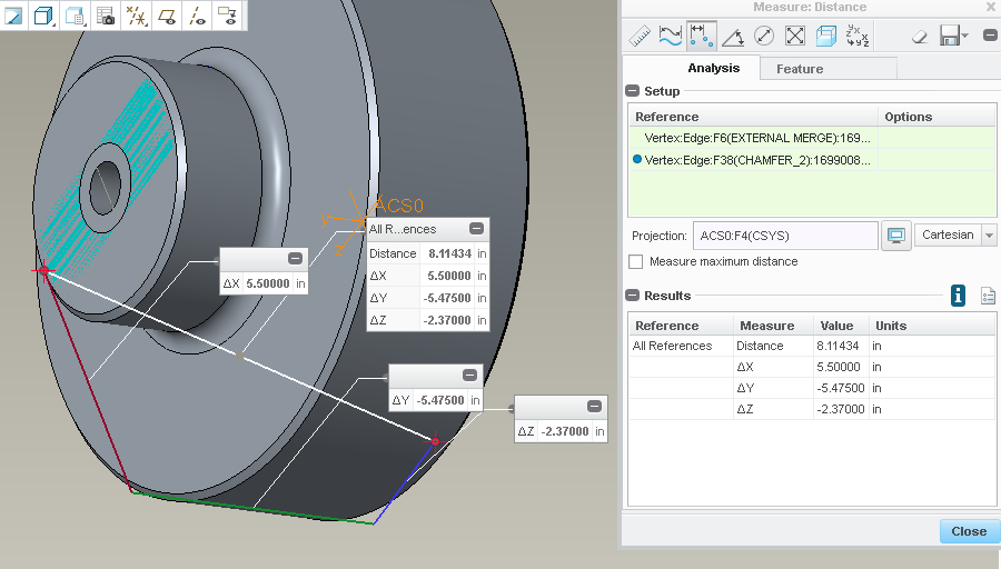

    March 15, 2017
    ok thing in measure tool that they have brought back in Creo 3.0 is the indicators for delta dimensions with respect to the coordinate system.
    This was there till Creo 1.0 and removed in Creo 2.0 and now is back with Creo 3.0
    Since i mainly work in Creo 2.0 so i missed this.
    StephenW
    March 15, 2017
    Yes, it's reasonable in Creo 3.
