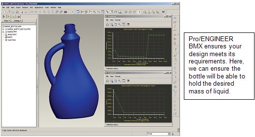

Pro/ENGINEER BMX automates this process for you, using design studies. To conduct a design study, you simply define your engineering goals, then define where your design is flexible, and Pro/ENGINEER BMX automatically analyzes countless iterations before arriving at the best solution.
Pro/ENGINEER BMX raises the level of design automation from simple geometry creation to a fully engineered solution. All you need to do is simply pick the best design and move on to your next task.

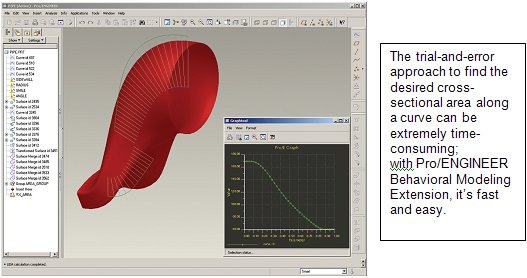

Pro/ENGINEER BMX can also optimize specific features within a design by creating “smart models.” Smart models capture design and process information, so that the model has the built-in intelligence to actually understand its function. Pro/ENGINEER captures this knowledge as a feature, which is automatically evaluated against the requirements–as the design evolves. This automation will increase your level of confidence that the design will function as intended–the first time. It also means that engineers can focus their energy on developing the design rather than continually checking engineering requirements.
Pro/ENGINEER BMX saves you time and effort in many ways. For instance, very often you need to use complex formulas to calculate design variables. And, usually, these calculations require third-party tools. Just imagine if your design software automatically read the output from those third-party programs and automatically updated your design? Not only would this save you time, but it would also eliminate the need to manually input values, thereby reducing the risk of errors.
With Pro/ENGINEER BMX, this is more than possible–it’s easy! Only Pro/ENGINEER BMX features an open, extensible environment that enables organizations to integrate diverse external tools into their design process.

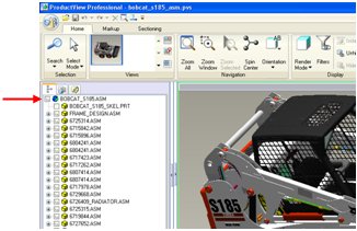

1)  Launch ProductView Professional either standalone or by selecting the thumbnail on the Details page in Windchill for the desired assembly.  (If using standalone, open the assembly by selecting the desired *.pvs file)
2) In ProductView, select the Blank Square next to the top level assembly to Load All Parts
3)  Browsing and Selecting components
Using the Product Structure for Selection
  • Deselect parts/subassemblies by unchecking the box in front of the file name for any component or assembly
  • Multi-select from structure or on model by holding down the control key and selecting with the left mouse button.
  • In the Structure, the user can also select an item, hold down the Shift Key, and then select another item further down the list to select all items in between.  (If necessary, open subassemblies in a new view to verify content)

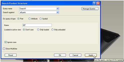

Using Search for Selecting Parts/Subassemblies
  • Name Search
    • Select Search from the Home tab
    • After the Search window opens, enter a Name if this is a search you may end up repeating
    • The user is presented with the option of 3 types: Part, Attribute and Spatial.
    • Select the Part option and browse down to Name block.  Enter a name or a partial name using * as a wildcard and then select Apply.
    • Go to the Product Structure, highlight the top level assembly, hold down the right mouse button, select Collapse and then choose Selected Parts to 1 Level.
    • Select in the box next to the top level assembly to Unload All.
    • In the Search Results, hold down the right mouse button and choose Select All.  Hold down the right mouse button again and choose Select in Product Structure.

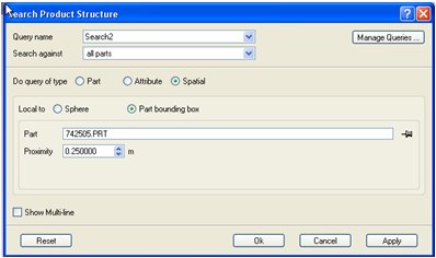

  • Spatial Search
    • On the Search window set the type as Spatial and then choose either Sphere or Part Bounding Box.
    • If using sphere, use the Pin icon to locate the center of your search and enter a Radius value to define the extents of the search.
    • If using Bounding Box, select the part of interest and set a Proximity value.
    • Select Apply to run the search.

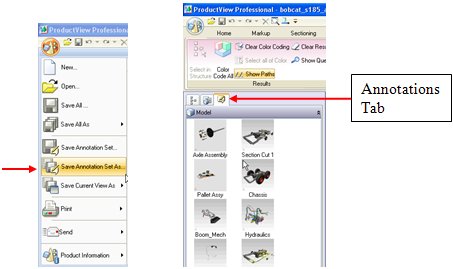

4)  Using Annotation Sets to save
  • Once the user has identified the parts of interest for the Simplified Rep, go to the circular icon in the top left corner of the window and choose Save Annotation Set As.  Enter a Name for the annotation as well as the Author and Comments.  OK to finish.
  • Go to the Annotation Sets tab to the right of the Structure tab to see a list of annotations and double click to open the one of interest.
  • Repeat for each Simplified Rep the user would like to create.

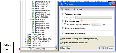

5)  Minimize the data shown in the Structure tab
  • Go to the Filter bar at the bottom of the Structure tree, click on the bar with the left mouse button and on the dialog box which appears, check the Only Selected Parts option.

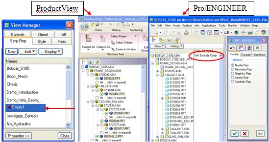

6)  Creating the Simplified Representation in Pro/ENGINEER
  • Open a session of Pro/E and open your assembly using the By Rep option.  Choose a Simp Rep which contains zero components or create an empty rep on-the-fly from Simp Rep dialog box.
  • Open the View Manager, select the Simp Rep tab.  Create a New Simp Rep, enter a name and set the Default Mode to Exclude. Select the Include tab and use the Model Tree to select components/subassemblies.
  • Compare Model Tree in Pro/E with Structure in PV to manually select parts/assemblies to be included in new Simp Rep.
    • Have your ProductView window set up so that the Product Structure is on left edge of the screen, have Pro/E on top and set the left edge of window so the ProductView Product Structure is visible.
  • When using Windchill PDMLink, expand assembly nodes only as this will download only the assembly files and not all parts/subassemblies
