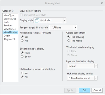

I am not an export on fixing imports. The users I know who fix a lot of them are usually those who have surface modeling skills. I do not. I have occasionally been able to fix some simple stuff. I always try. Sometimes the export is intentionally made to be surface models only.
For the drawing, there are settings. I have lots of surface models..
config.pro options
HLR_for_quilts YES
In the view settings, make sure you have "hidden line removal for quilts" set to yes.

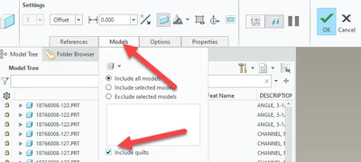

If you have cross sections on your drawing, you'll need to edit the section in the model and under the models tab and check the "include quilts" option.

The "purple" lines would mean that the import is a surface model and not a solid model. Nothing has changed with respect to that.
Other than being a different color in the drawing, what issues are you having with them. There are several settings that make surface model less problematic on drawings.
The best solution is to try to get your step files to solidify during import, not always possible but sometimes it pretty easy, just depends on the model.

The other issue besides the color is that any part with these purple lines shows up as a wireframe in any assembly drawing that it's used in, even if "No Hidden" is selected for the display. This is a massive problem, as that means the affected part shows up through the rest of the assembly even if it's buried under a frame, panels, etc.
config.pro options
HLR_for_quilts YES
