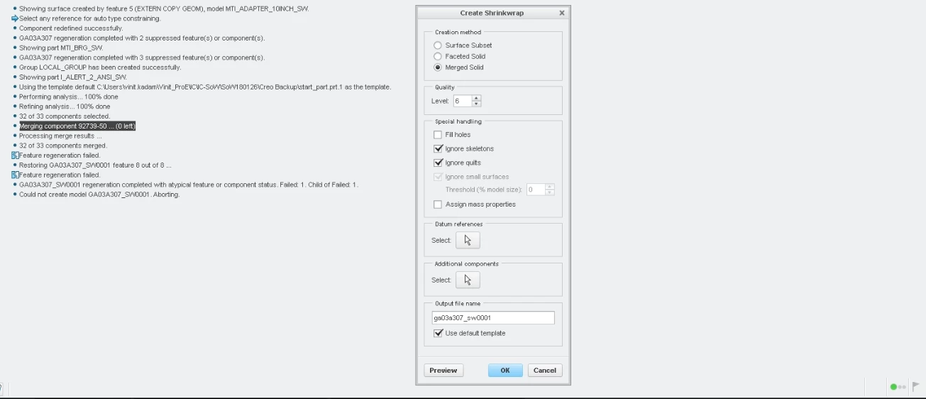

I have one large assembly & I am doing Shrinkwrap (Save as Shrinkwrap) of this total assembly.
When I follow the steps as below;
1. File--> Save As --> Shrinkwrap
2. Merged Solid -un-check fill holes
3. Clicked OK
then in message bar at down in creo, it is showing - 'Merging component' completed. (Find attached screenshot)
But at the last I am not getting Shrinkwarp file. I am getting error message as below
"xxxxx_sw0001" regeneration completed with atypical feature or component status. Failed: 1. Child of Failed: 1.
Could not create model xxxxx_SW0001. Aborting.
How to search the exact part/feature in assembly because of which I am getting this error??

One place I would look for more information is the trail file.
The approach I would take is to suppress components until the Shrinkwrap worked.

I opened respective 'trail.txt' file; this file contains around thousands of lines.
Please guide me how to find which part is creating issues in shrinkwrap process.
Find attached respective 'trail.txt' file. (ohh not able to attach trail.txt- getting error 'The contents of the attachment doesn't match its file type.')
Regarding 2nd approach, in my assembly there are total 83 parts (Feat# count - I mean parts & sub assemblies), so I feel this is time consuming approach to suppress components one by one. And find out the component which is causing issues in shrinkwrap process.

Creating Shrinkwrap is quite cumbersome for assemblies many times and normally be a trial and error method.
I would first hide any surfaces, cosmetics, then check and fix any geometry checks, suppress any internal components that are not visible from outside, suppress any Text features or threads.
If there is any complex casting model, then sometimes matching the accuracy of that part and the assy will work.
