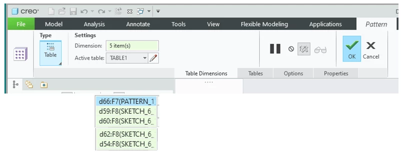

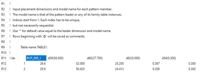

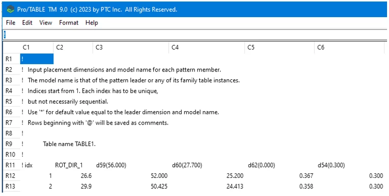

I have a table pattern in creo where an angular dimension is considered in the table which i didn't find in the part. In the pattern table the dimension name is ROT_DIR_1.
Which dimension is this? Please reply if anyone have the answer. Thankyou.

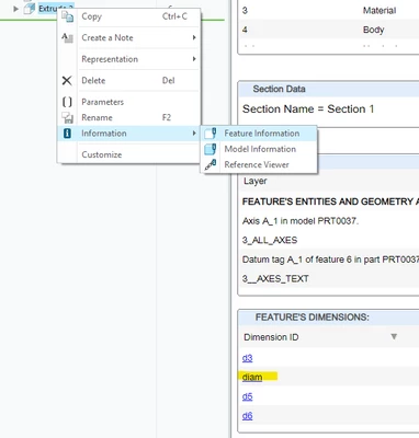

You can view any named dimensions in the info of a feature.
RMB on feature in tree and select Information > Feature Information and scroll down to FEATURE'S DIMENSIONS section.  Hopefully you don't have a lot of features to pick from.

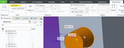

If you use Edit Dimensions on a feature and select a dimension, the name can be found in the Dimension tab.

In the information, it shows d66. But i am unable to find it in the feutre. please check it and let me know. Thankyou.

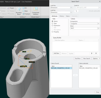

Try searching for this dimension.  Use CTRL+F or click
Then find dimensions, looking by dimensions
If it is found, the relevant feature will be listed in brackets, e.g.:

d66 is that dimension, but i am not getting that in the feature.

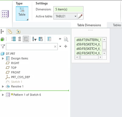

Can  you post a screenshot of the Pattern feature with dimensions and the Table? That could give an insight as to what is happening.

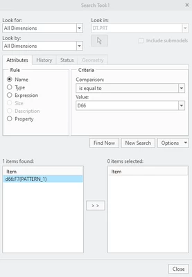

The dimension d66:F7(PATTERN_1) is not there inside the feature. The same dimension is added in the table as ROT_DIR_1.
Sep 15, 2023 7:27 AM UTC
ROT_DIR_1 = d66
  • you cannot display none of these names ... they are hidden inside pattern feature
  • I do not have any idea how did you created the model, therefore I cannot explain its behavior
  • try to create model once again and note down the exact procedure
