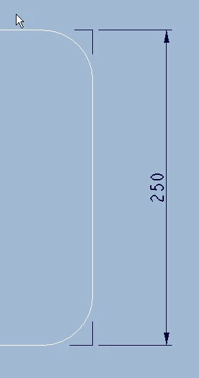

In a drawing, is there a way to easily add "virtual sharps" to radiuses for dimensioning? See attached for an example of the "virtual sharp" I'm trying to find a way to easily create in a drawing.
Best answer by Kevin
You can add them by creating draft entities using the Use Edge feature, trimming the entities, and grouping them to the view. Unless there is a specific reason for what you have shown you don't need to add them to a drawing.
August 16, 2010

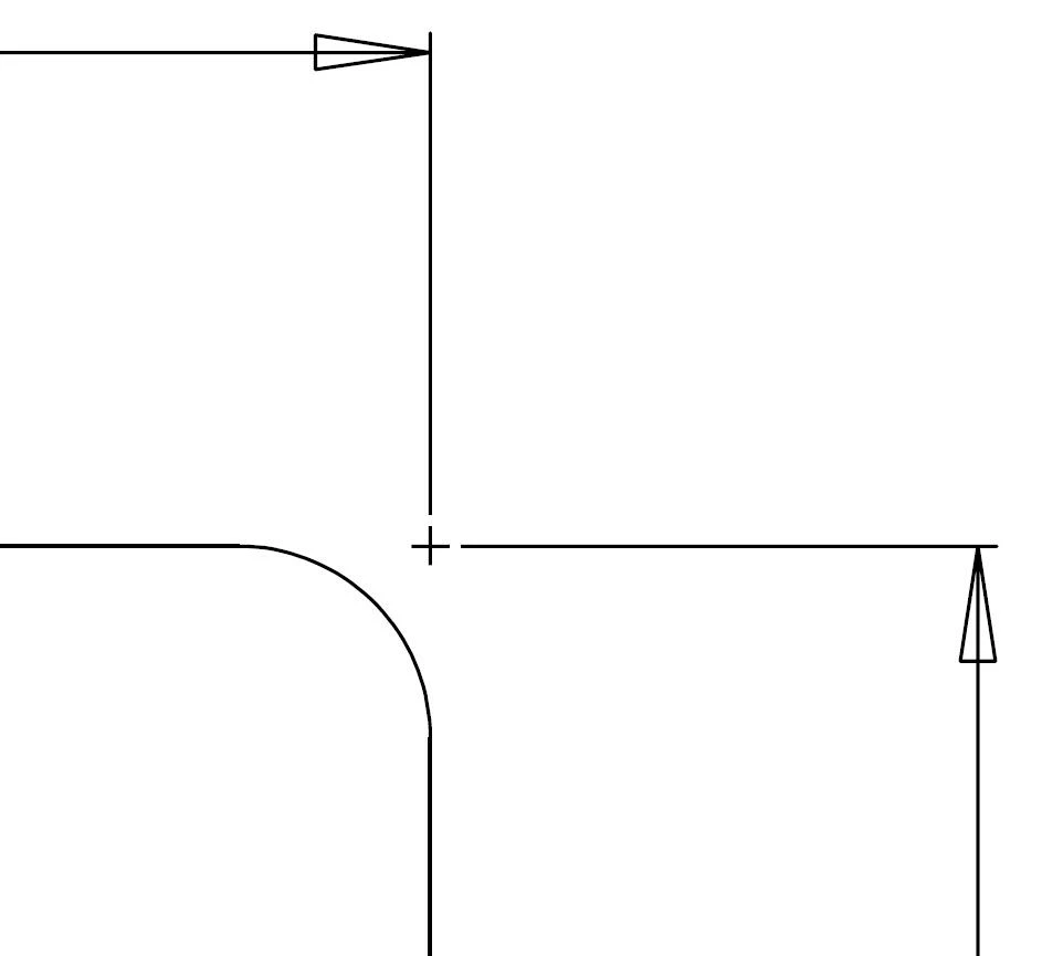

You can use 2D detail setup option witness_line_intersection yes to display the intersecting witness line.
For this you have to create dimension with intersection option.

  1. set drawing option witness_line_intersection  yes
  2. create drawing dimension using intersection of two entities

I would also say you want to specify which version the option is for. Not everyone is using WF5 and as far as I know, unless something has been updated, versions earlier than WF5 do not have this option.
August 16, 2010
You can create an axis in the part using the two surfaces as references, then in the drawing show the axis and either dimension to the axis or use the "Intersect" option using the edges as references.
August 23, 2010
Sometimes I'll use the axis as mentioned, either as a stand-alone feature or more often as an "axis point" created in sketcher, or sometimes I'll actually even create a datum curve specifically for that.

Another useful thing to remember about this issue is the following: If the radius in question is part of a Sketch (as opposed to being the result of a Round feature), a sketched point can be placed on the sharp corner before it is filleted. You can dimension to this point within Sketcher; then the dimension will already be in the model so that it can be Shown, as opposed to Created, within the Drawing.
August 24, 2010
To take David's point a little further, a dimension (driving or otherwise) can use either a sketcher point or axis point as a reference. This is done quite often. Be aware, that an axis point is not available when in sketcher mode in the creation of datum curves, sweeps, blends, VSS's, or revolves.
