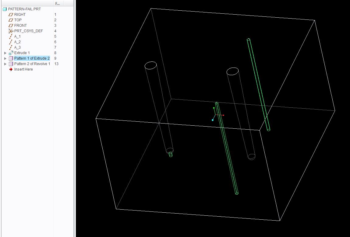

The second pattern is a reference of the first.
May 22, 2014
You are using a reference that is not able to pattern in the direction you selected.
I added a plane specific for the sketch (internal) and I added a sketch centerline for rotation. This corrected the reference pattern.
Creo 2.0 attached (M040)

I would still think the the reference should work, especially since I can successfully pattern with the same steps as the first pattern. In theory the reference being those same steps.
May 22, 2014
Reference patterns are very particular. Half the time they fail and I just re-use the previous transformation instead. In your case, there was something it couldn't re-reference to the sideways location.
