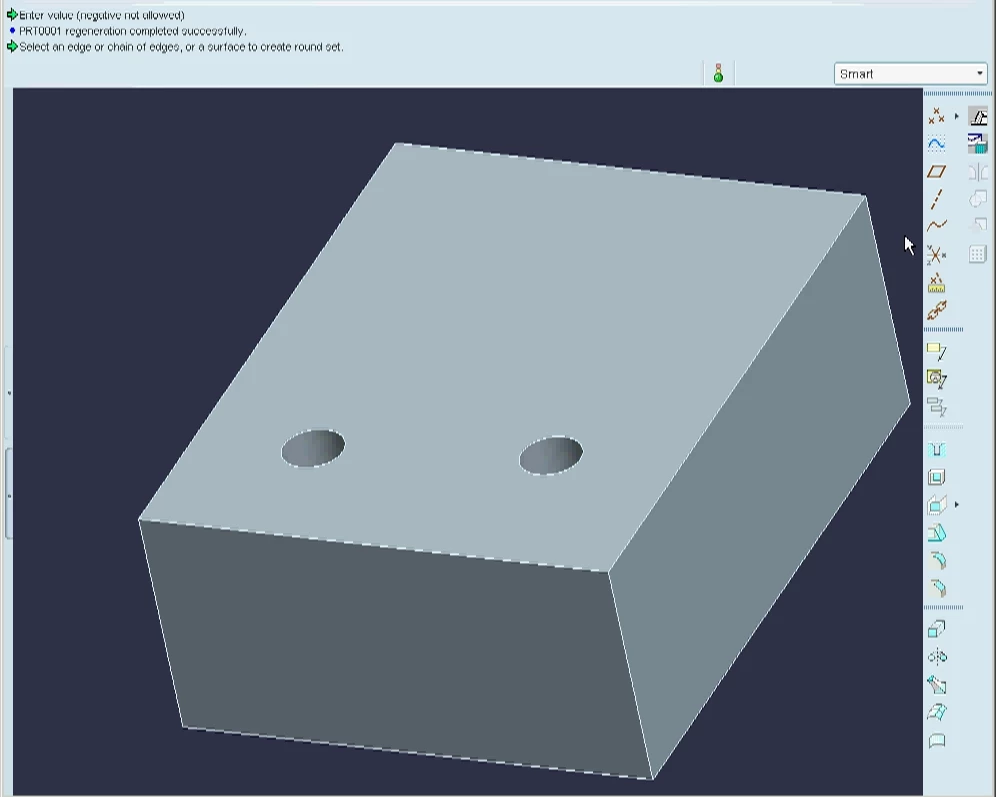

This small video shows how reference features can be used together with a smart querie. In this example, all edges of holes are queried, this query is added as selection to a reference feature, and based on this feature, a round is created.

    June 29, 2012
    Hugo,
    Very cool example of a user defined Intent Reference Feature with a query, and the updates that happen new hole features are inserted above it!
    I have added a document that discusses the different types of Intent Objects that are available, and my Planet PTC Live 2012 powerpoint presentation that contains further detail on Rule Based References, Intent Objects, and user defined Intent Reference Features for automatic placement of UDFs.  I hope it's helpful!

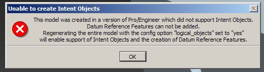

    Great video, thank you. I thought I would give it a try, but I failed. When I click the 'Insert a Reference Feature' icon (the little chain) I see an error message:
    I have added the required config.pro entry and restarted Pro/E. In fact, I deleted the whole part and re-created it after I had restarted Pro/E, so there is no doubt that the config option was set when this part was created.
    Sadly, I still get the same error message.
    I know I have had this feature working before in WF2, so I doubt if it is a version-related problem.
    Any ideas what I may be missing?
    WF4, M220
    John
    May 17, 2013
    I found the answer on MCadCentral:
    We changed from 32 to 64 bit OS and from WF2 to WF4.
    In order for our Intent references to work, I had to regenerate the Start Parts.
    All present and correct now!
