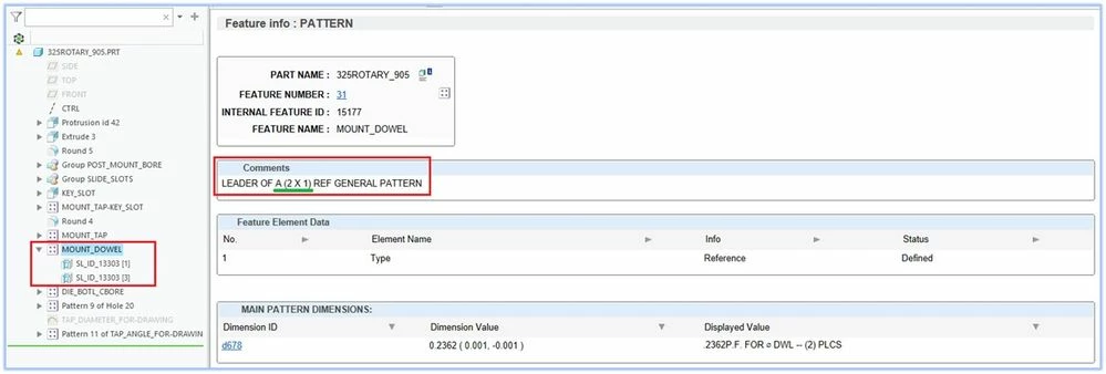

Is there any way (hidden or otherwise) to extract the number of pattern members in a reference pattern for use in a note or dimension text?  Manually typing in ‘dumb’ text is not at all parametric and is leading to discrepancies between the geometry and the callouts (in the model and in the drawing).
Clearly the reference pattern knows it’s quantity.  I’m just not seeing any way to extract this for use in a note or in dimension text.

Well, I can recommend this hack:
Pattern by reference a dummy "standard" hole.
(Make the hole point away from the part so nothing is actually drilled out in the solid)
Then, you can extract the &PATTERN_NO parameter from the generated patterned hole note.
This method generates a parametric reference which gives the correct total even if any pattern instances are "suppressed" (you know, when you can click on the black dots and turn them white while in the edit pattern definition)

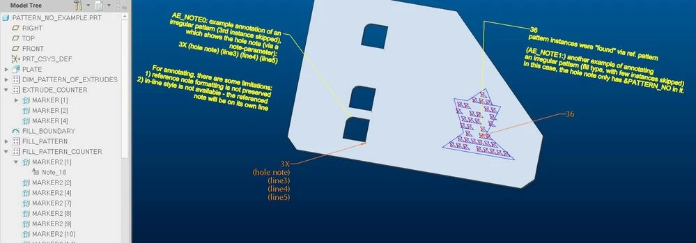

@pausob, Essentially what you've discovered is that the PATTERN_NO hole note token will continue to work with reference patterns even though the reference pattern itself never visibly exposes its quantity as a parameter or dimension.  Fascinating.
January 8, 2021
Yeah, this hack of adding a pattern of dummy holes and showing its PATTERN_NO can work as a "counter" when annotating patterned things, but probably it is better left as a fun example of a Pro/WORKAROUND(TM):
It is not user friendly as you have to add this mysterious group of holes out in space.
Also, it seems that the solution is only of visual value; I misspoke earlier and in fact I do not know how to "access" PATTERN_NO and assign its value to another parameter.

I am a bit late to the party here and this only works for a specific case, but if it is a simple thru hole then you can change it to be a threaded clearance hole with the same clearance diameter and then edit that specific feature note generated to be just &PATTERN_NO
You can then include &note_1 on a drawing somewhere.
Obviously this doesn't work if you need the normal note (without hijacking it).
As far as I can tell you also can't extract threaded notes into parameters so this solution only works if you need the number only in a drawing somewhere.
