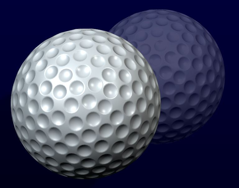

I tried to create a golf ball, but after creating a sphere i thought of creating a small hole and then by giving a pattern i thought i might get it, but am not able to create a pattern as it is seen in Golf.. how do i create it??images.jpg

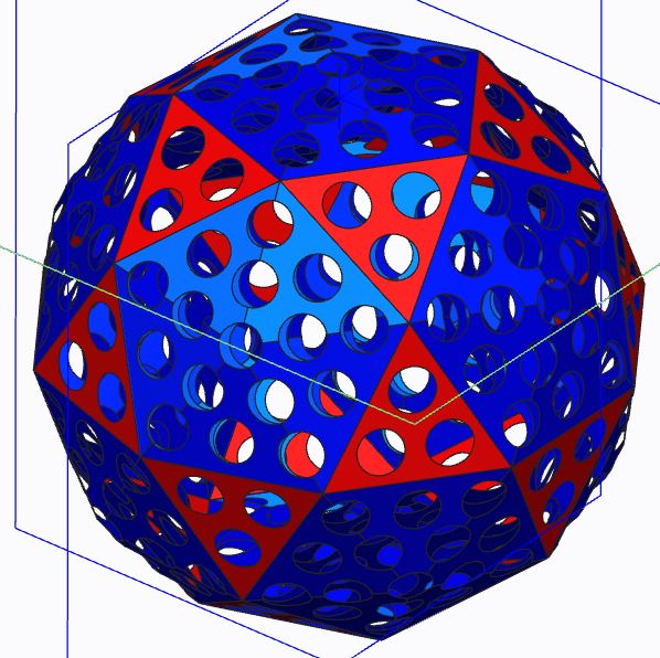

I got this a long time ago, and never looked at it:
March 13, 2013
That model was a lot of effort by someone. I wonder how those pattern tables were generated.
Very nice work, whoever did it (the History interrogation still doesn't work in Creo 2.0 M040).
It does return a username EBOWERMAN.

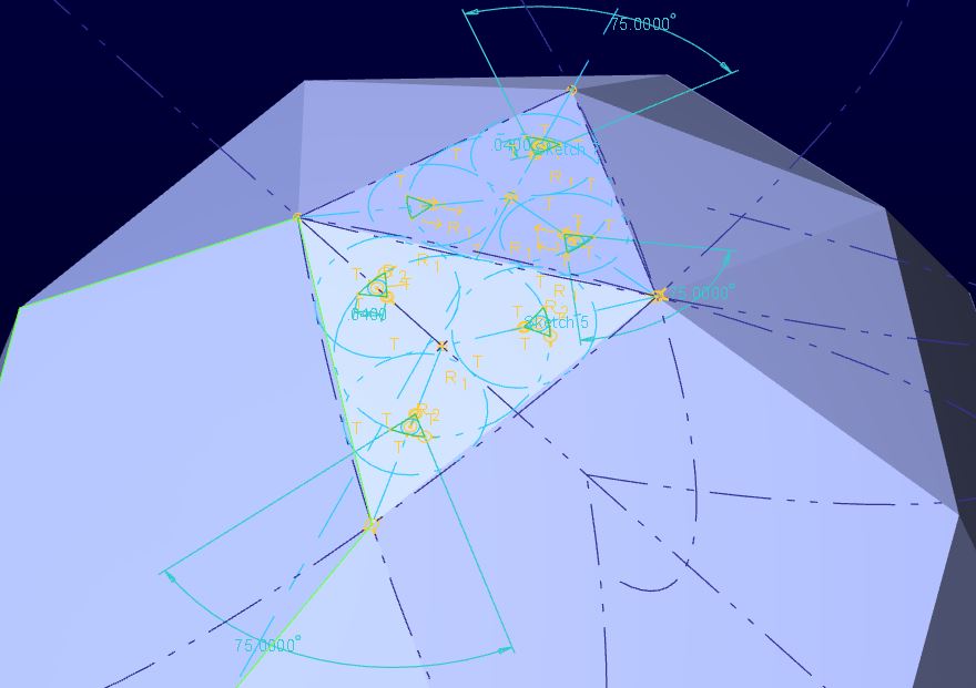

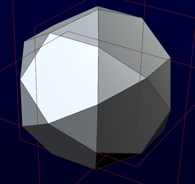

So I started here and it certainly is not complete.
I used the Wiki example on the left as a guide. This creates a 252 hole golf ball.
http://upload.wikimedia.org/wikipedia/commons/f/f0/Two_similar_icosahedron_golf_ball_designs.jpg
I am only using this as a skeleton starting point. The dimple sizes are not optimized nor is the size.

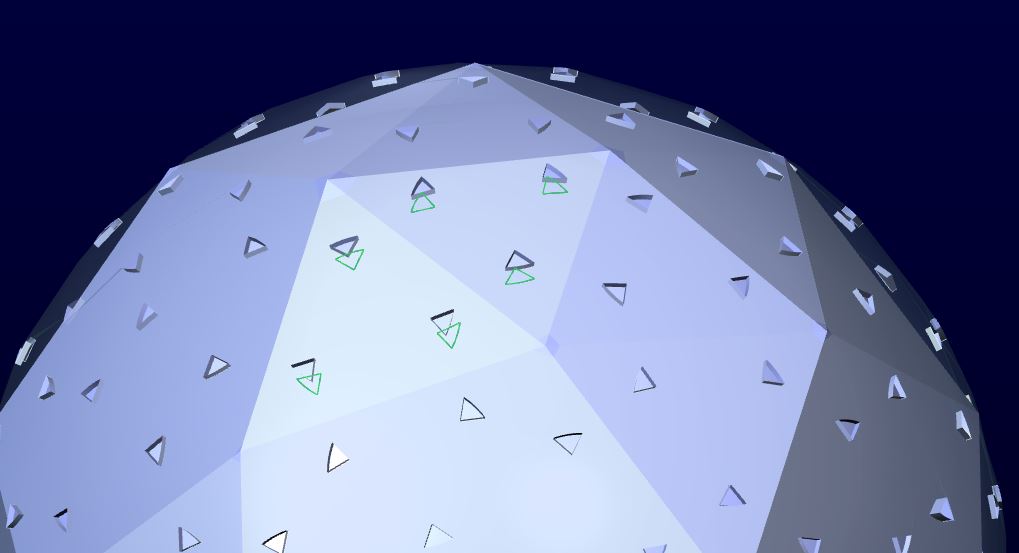

Reverse engineering both images shows that it is based on a nested set of 12 pentagons and 20 triangles. With Pro|E (all versions) you can assemble these shapes and they end up locking themselves into the proper form.
From the assembly I drove a sketch back to the pentagon to determine the height of the 5 triangles on the pentagon so I could determine the diameter I ended up with. Again, none of the holes are optimized as yet.
The idea is that you want to be able to define this shape within a part file and not an assembly. Holes, or points, still have to be mapped on a sphere. The dimple sizes are not consistent... you see the full scope of the challenge. And this is not even the definitive standard for golf balls although I do like this one for the challenge at hand.
The next level of subdivisions should determine exactly where the dimples should fall. In that way, points could be added to determine the appropriate location on the sphere.

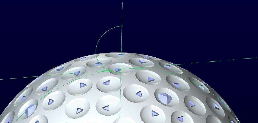

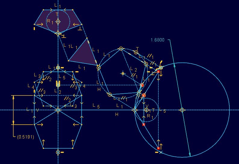

Mani, you have unintentionally started a surprisingly challenging discussion and quite a few off-shoots.
And since you started it, I should follow up. I spent most of the week trying to "understand" the problem rather than just making due. Between the challenge itself and making Creo do what it should really did provide a lot of insight and even frustration.
This is what I ended up with: 260 dimples on a 1.68" sphere. This model is attached as a STEP file.
I ended up using 3 levels to manage the point plotting onto the face for patterning. This technique could be used for any pattern, but I choose the Wiki version with a few extra holes at the centers of the resulting hex pattern.
The 1st level was as discussed before, a modified dodec/icosahedron (32 faces).
I was finally able to generate this shape with a comprehensive sketch that controls planes from which the "fill" patterns were created.
Next, I needed to stellate one of the pentagons. Through the sketch, I was able to determine the of the center on the bounding sphere. Then 2 key sketches were created to determine the centers. These odd sketches will determine the "centers" of the dimples at the points of the pie shaped pieces.
A surface sphere of the final size was created. These sketches were used to create Offsets. This provides Vertexes to use for patterning later on. The offsets were patterned on a hemisphere.

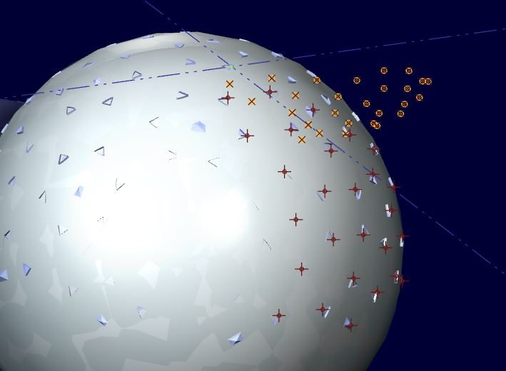

Now, 95% of the work is done. I have vertex locations on the sphere surface. Next a solid sphere is created and a 1st dimple is revolved from the solid face.
Now, I -thought- I could make datum points on the surface using the "darts" I created. But patterning to those points does not maintain a surface normal. All the axes of the pattern became unidirectional without options. Even if I tried to orient the points, no joy. The answer was to map the points onto a sketch in the pattern command. This was easy enough. Now you have the options of mapping to surface normals. remember to choose the Origin as well.
Now I am able to modify the 2 simple sketches above and optimize the distribution of the dimples by tweaking the sketch constraints. You will notice I used one size dimple. Even greater optimization could be done if you separated the dimple creation in 2 steps.
From here, this patterns were copied, pasted w/ 180 degree rotation, grouped, and rotated about an axis 5 times. And last, the fillets were added.
To clean up the file, I hid all the reference geometry and also the 260 axes that were created from the dimple cuts and saved the layer status.
And the end result is attached

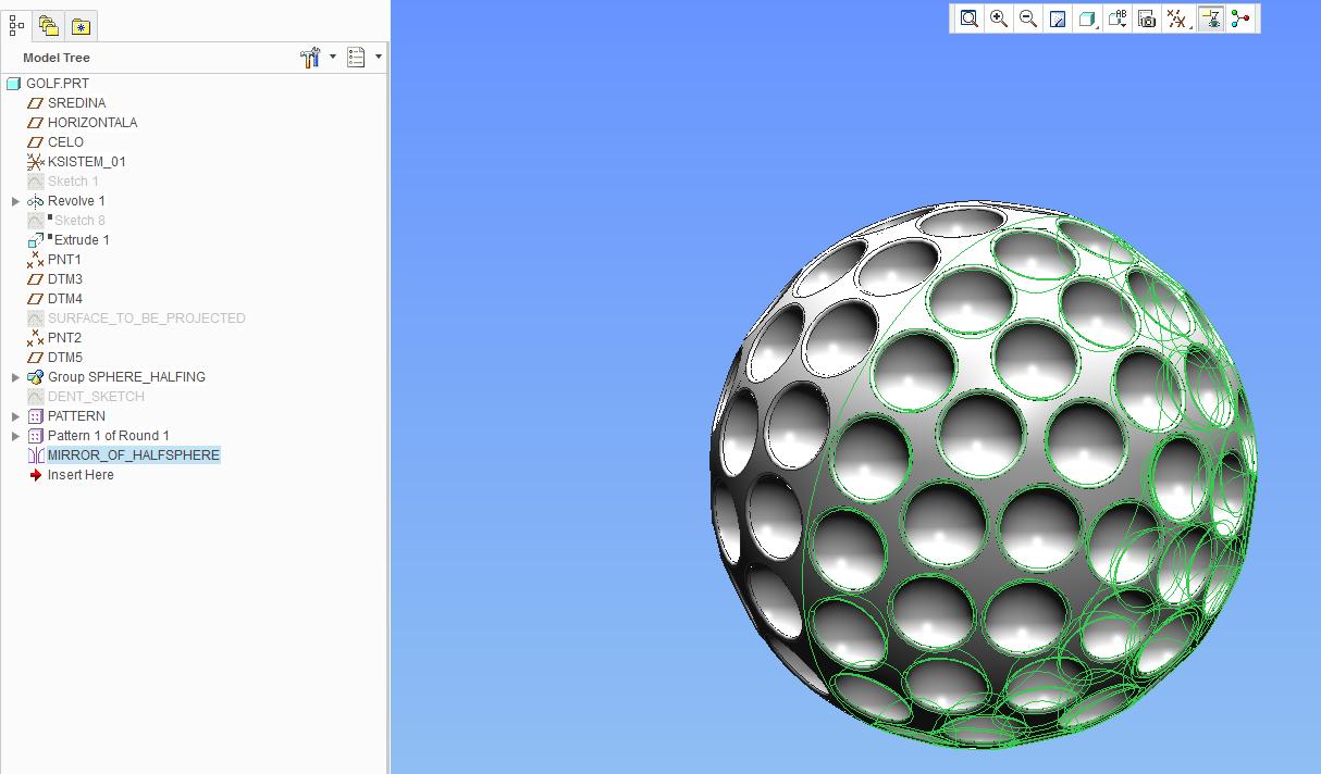

Trick is to make half sphere not whole sphere and then project pattern on to it. Fill Pattern type must be circular. First dent u create in center of halfsphere surface. when you complete halfsphere you just mirror it.
Now comes problem with distance between pattern items on 1 halfsphere and other. You must use a bit of math in relations to achive nearly perfect ball.creo+golf+ball.jpg
Here is the model:
