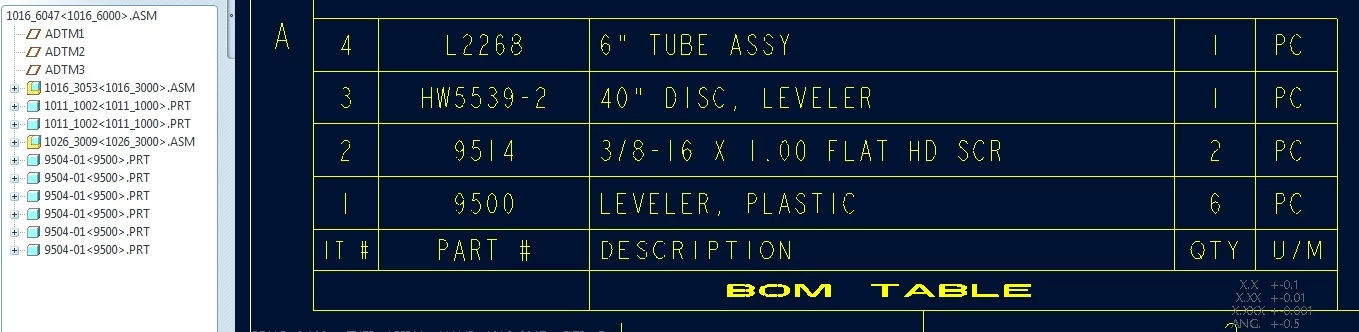

This is very baffling.
I thought we had fixed this with verifying the instances in the table.
I have a drawing that shows instance 9504-01<9500> in the model tree, but the BOM has the parameters from 9500 generic part. (See BOM_INST.jpg)

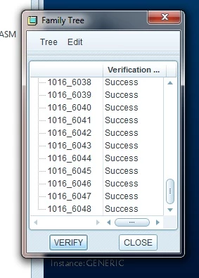

I checked to make sure that the instances of the part had been verified. (See BOM_INST2.jpg)

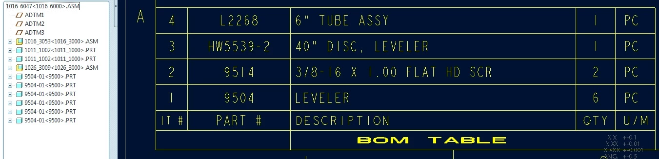

I regenerated the drawing and now instance 9504-01 <9500> shown in the model tree also is shown as 9504 in the BOM (See BOM_INST3).
What else could possibly be going on with the drawings/parts? I would like to avoid having to regenerate every drawing before printing to make sure that the BOM is correct.

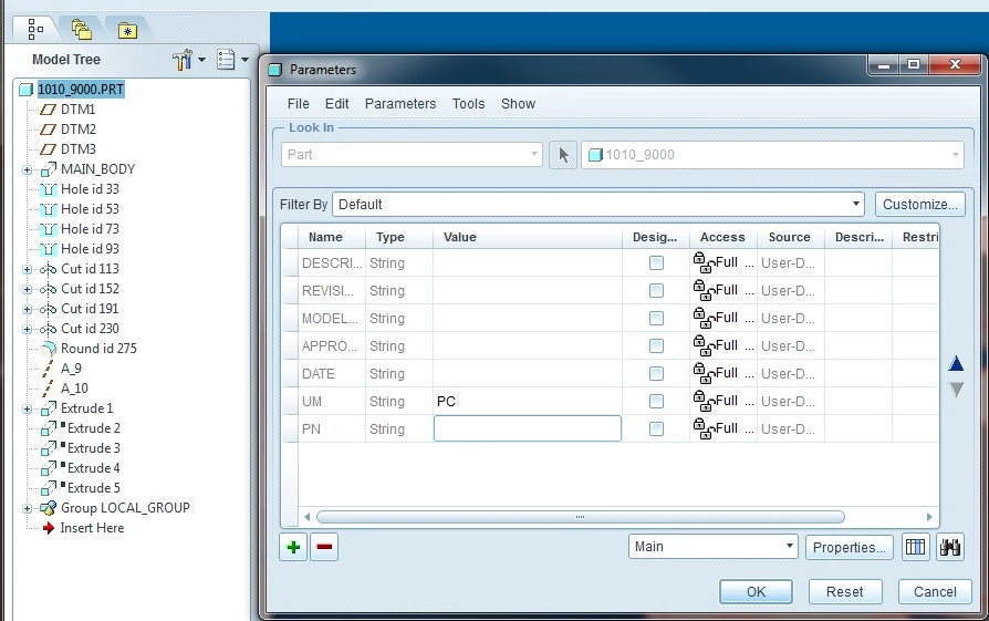

While talking with a rep, after getting some new licenses installed, I was showing him this problem.

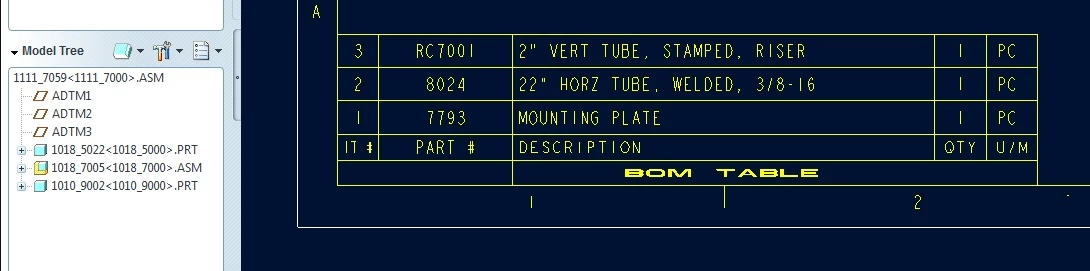

I noticed that the UM (unit of measure) had propagated, but not the description nor the PN (part number) parameters. (See WW_BOM_7)
I also noticed that UM was the only parameter filed in on the generic part even though the parameters had been filled in on the instances needed.

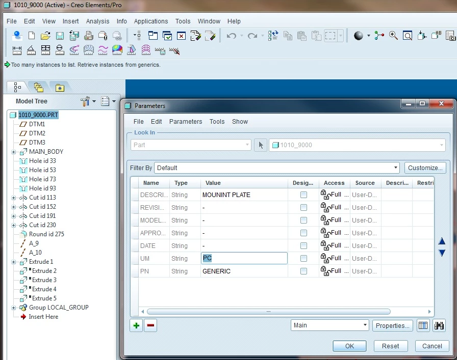

I quickly tested that discovery by adding values for the parameters of the generic. (See WW_BOM_8)
I saved the generic, the instance and regenerated the assembly and save it and then even closed out of Pro-E.
When I open the assembly, the values for the BOM table were in place and intact. (See WW_BOM_9).
The explanation that I received is that the null values in the generic are triggering the part to not regenerate the parameters of the instance into the BOM table. Once these values were no longer a null value, they will automatically propagate the table.
