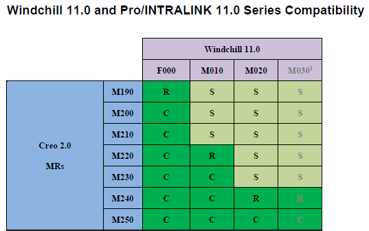

What build of Creo 2.0 are you running?  Windchill 11 requires at Creo 2.0 M190 at a minimum.
April 24, 2017
You should also recreate your local cache after an upgrade.
April 24, 2017
did you check whether you Creo 2.0 version is compatible with Windchill 11 ?
What Creo 2.0 version do you use ? Starting from M210, it is necessary to install Creo Agent manually to enable proper communication with Windchill.
