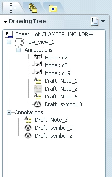

Can you somehow determine if all draft items on a sheet are related to a view or a dimension? Especially in WF 2, but I would also be curious if you can in newer releases also.
I'm interested in items like symbols, draft lines, notes that are positioned with respect to a view or dimension. I located something in the find function for symbols but I can't make it do anything remotely useful.
I know model check can do it, but getting that set up around here is like pulling teeth, only with more pain and suffering.
Apparently UG can highlight all items associated to a view when you select the view and I am really tired of hearing how good UG is.

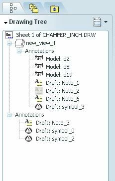

March 15, 2010
Steve,
In Wildfire 5.0 we also implemented a Drawing Tree. This tree structure
lists all of the drawing entities and also groups all of the items
related to a view under a node heading for that view. Selecting on any
item in the tree will highlight the item in the graphics area.
Raphael
Raphael Nascimento
Product Manager
Pro/ENGINEER Detailing
StephenW
StephenW23-Emerald IIIAuthor
March 15, 2010
Thank you very much. This will prove helpful for reasons other than just the question at hand.
We can use little things like this to push for upgrades...
-----End Original Message-----
