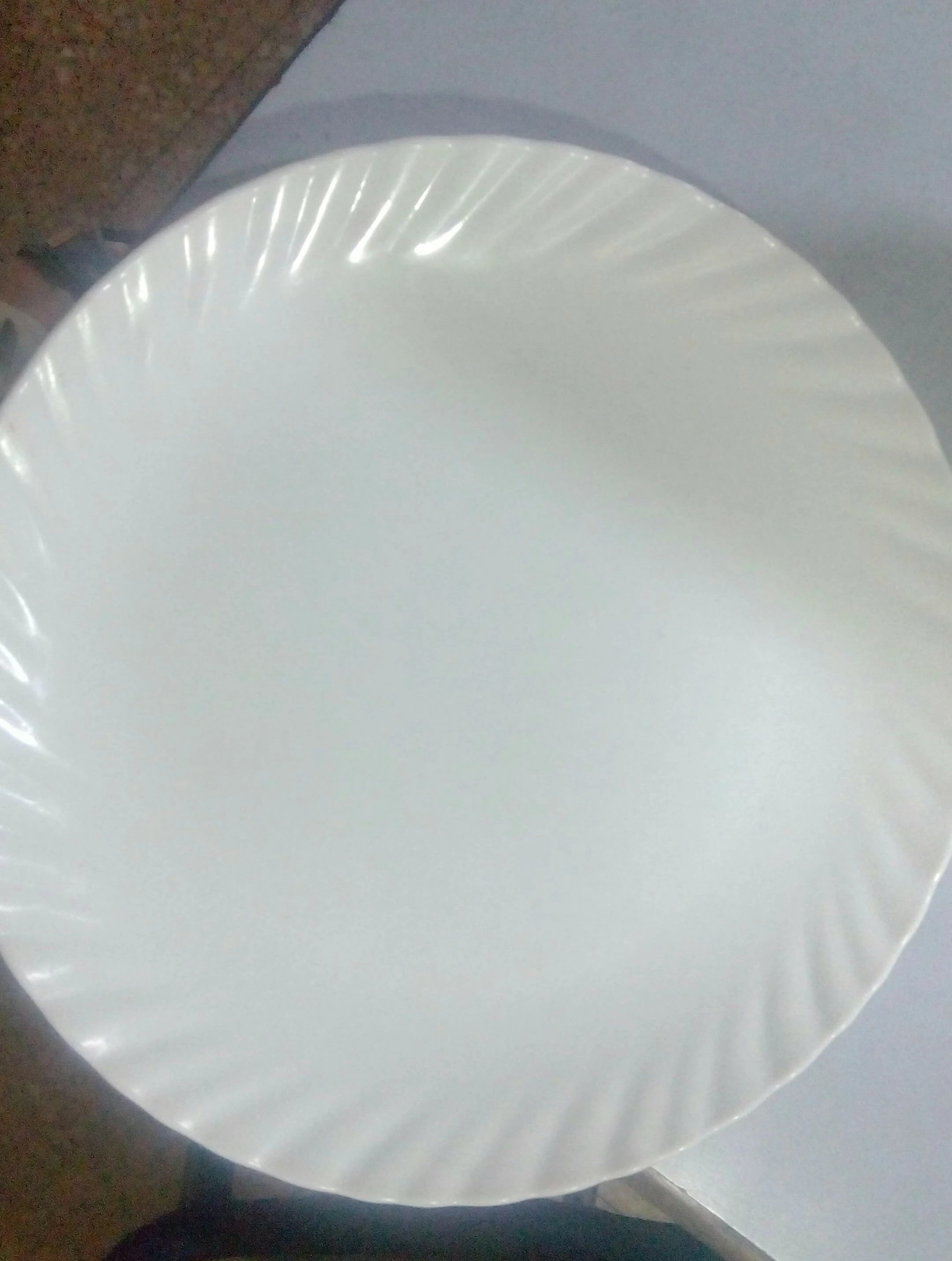

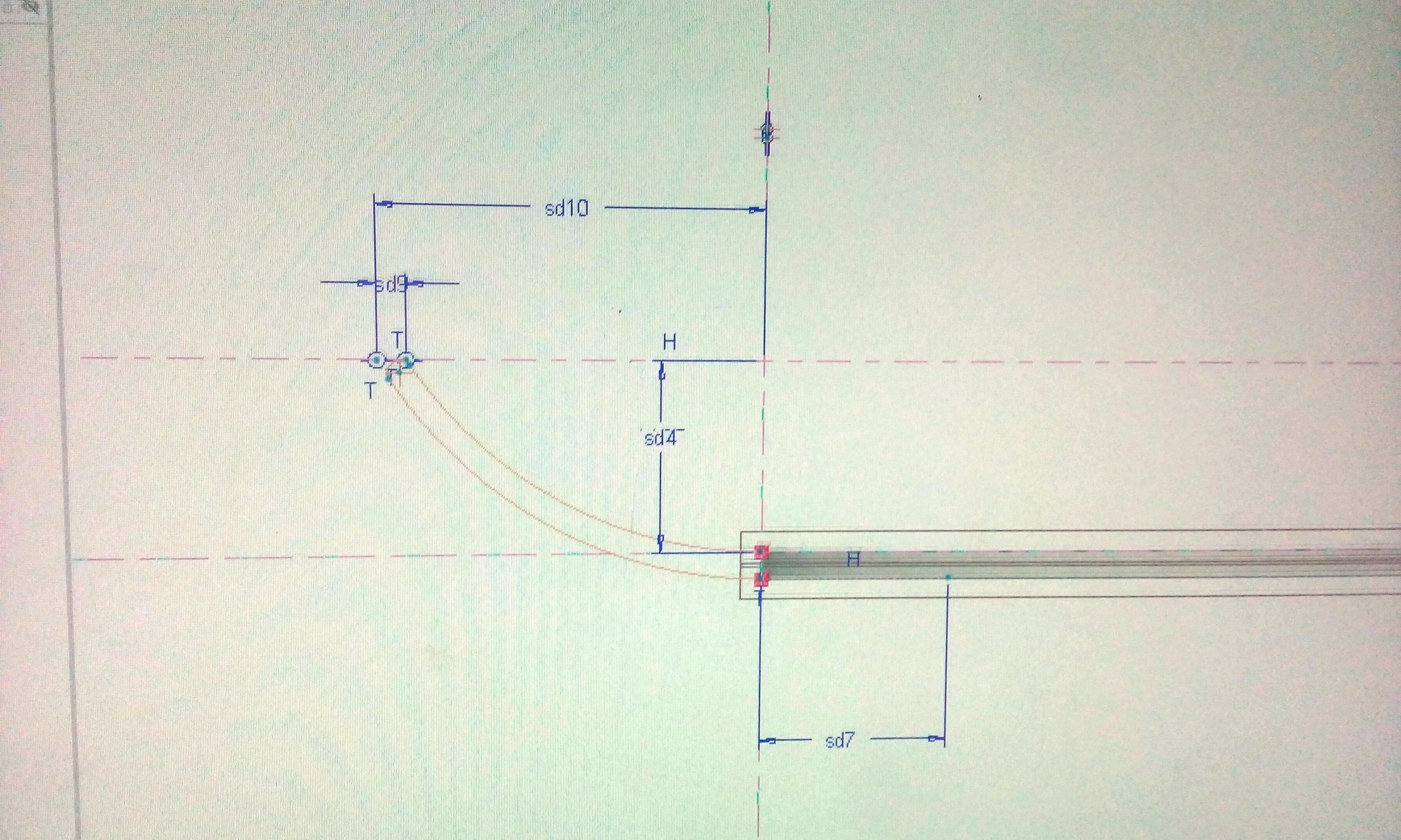

Dear Sir,
             I have problem to create outer design of dish. By using trajpar relation sd=5*sin(3600*trajpar)+sd,
but didn't get required design so please help suggest the proper relation formula.

    What is the value of SD?
    Sorry, that's a trick answer...  you have a circular argument.
    You are defining SD and you are using SD in the right side.
    nil1-VisitorAuthor
    May 24, 2018
    sd value is 29.4
    May 25, 2018
    Your required shape reminds me of this discussion:
    Modeling of canted spring
    If you patiently follow all the links, I think you can learn a lot about advanced sweep section relations using trajpar parameter.
