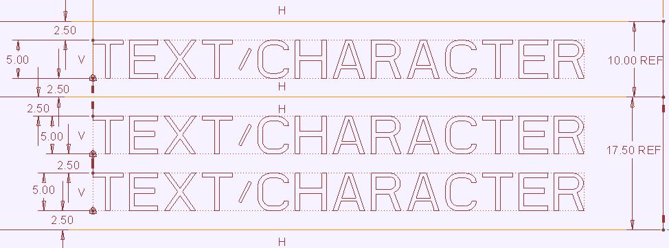

I do have table into creo drawing file. Table is having property of height and width. I would like to understand relation between Height in MM and Height in number of character.
Any clarification can be provided.
Thanks & Regards
Ketan
Best answer by kdirth
Close.
1 character height = 10 mm (5 mm character height + 2.5 mm top margin + 2.5 mm bottom margin)
1 character = 5mm, margins and spacings = 1/2 character
2 character height = 17.5 mm (2 x 5 mm character height + 2.5 mm top margin + 2.5 mm bottom margin + 2.5 mm spacing)
Just remember character height for the table does not change if the drawing options are changed and the drawing units measurement will always be measure by the units in the drawing options.
Hopefully this has not confused you, but I think you are getting the idea.

kdirth
September 28, 2015
The row height is based on the height of the default character height.  My default character height is 4 mm.  The row height is 8 mm to allow 2 mm of margin.  A row height of 2 characters is 14 mm - 8 mm character height, 2 mm margin top and bottom and 2 mm between rows.
