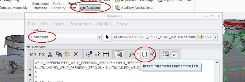

We use this the whole time.
Some rules:
The most interesting place to put the relations between an assembly and a part (or subassembly) in that assembly is in the component. This way the relations won't fail if you suppress the part for some reason, and you will still be able to open and edit the part without the assembly in memory.
A good practice is to use parameters in each part/assembly, and to write relations between these parameters.
To write a relation, you don't need to search for feature-ID's and component ID's. Creo will do that for you. Just click on the button to 'Insert Parameter Name from List', and select the part you want to see the parameters from. Creo will add the correct ID's by itself.
