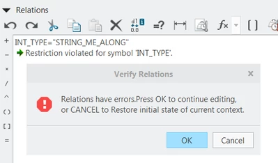

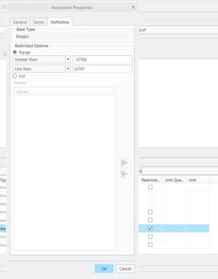

Anyway, I found a Pro/Work-Around if you want the error thrown if a "real" or "string" value is being assigned to your integer valued parameter: Make it a restricted integer type - let's say less than 32767 and more than -32768:
If this kind of parameter is then assigned an incompatible value:
