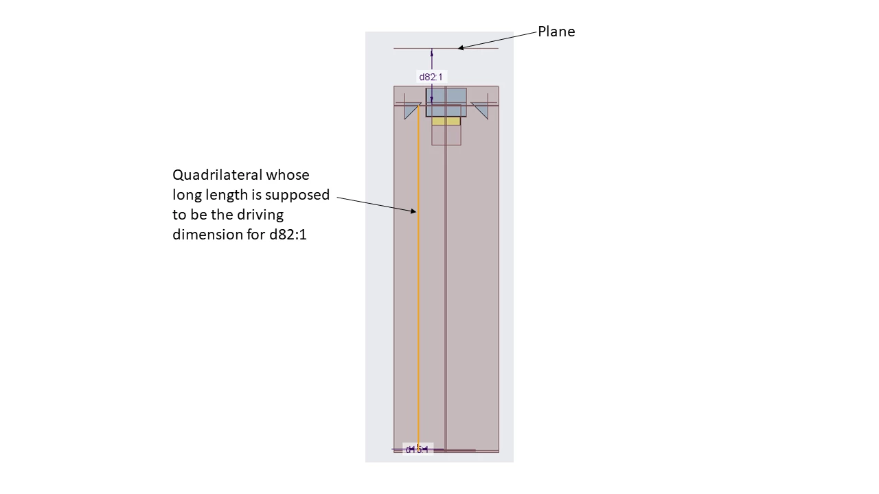

I have a sketch of a quadrilateral between 2 parts in my assembly and the dimensions of this quadrilateral are derived from the spacing between the parts (by putting constraint "Point on Entity"). Now, I want to establish relations for placement of another part with the dimensions of this quadrilateral. However, when I enter into the relations dialogue box and click on the sketch, the dimensions corresponding to the lengths of the quadrilateral do not show up. I understand that this is happening because it was not a defined length, but rather a derived length. But is there a way to access such dimensions in the relations dialogue box?

If I understand your verbal description correctly, you can use a reference dimension defined in your quadrilateral sketch in both part and assembly relations.
Using Driven and Reference Dimensions in Relations (ptc.com)
If this is not a solution to your problem, then please post a screen shot of the sketch with constraints and dims shown and describe the modeling dependencies relevant to design intent.

Thank you for your reply. This is exactly what I was referring to, but somehow I am not able to access that driven dimension in the relations box. I have attached a screenshot here in which the distance of a plane (d82:1) is supposed to be driven by the long length of the quadrilateral shown in the figure. That particular length does not appear when I click on that sketch or the extrude when defining the relation.
May 6, 2024 11:50 PM UTC
hmm, from your screenshot, it does make me wonder if the dimension would become visible if you first spun the view into an orientation where you could see all 4 edges of the quadrilateral, then clicked on the sketch or the extrude feature.
Because it seems you are viewing the quadrilateral sketch from the side - so a single line is showing (instead of expected 4)
I think Creo for some reason hides those dimensions that are in the plane orthogonal to the viewing direction.
