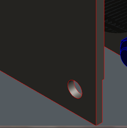

I did this........however it's leaving the edges as red, as shown in the picture. The actual part does not have any red in it whatsoever.......so I'm confused......
June 12, 2012
That looks like the component is still selected. Try clicking in the background in graphics window to deselect and / or repaint the window
June 12, 2012
Hi Kris,
I remember on old versions of Proe before Creo that if you paint entire part (in part mode) by selecting part name in model tree lets say white and then select all surfaces and paint them lets say black you will get model that is black with white edges.
I dont have ProE installed but you can try this and see if you get same result. Maybe you painted part red and someone picked all surfaces and painted them black.
Then again maybe my memory is playing tricks on me
