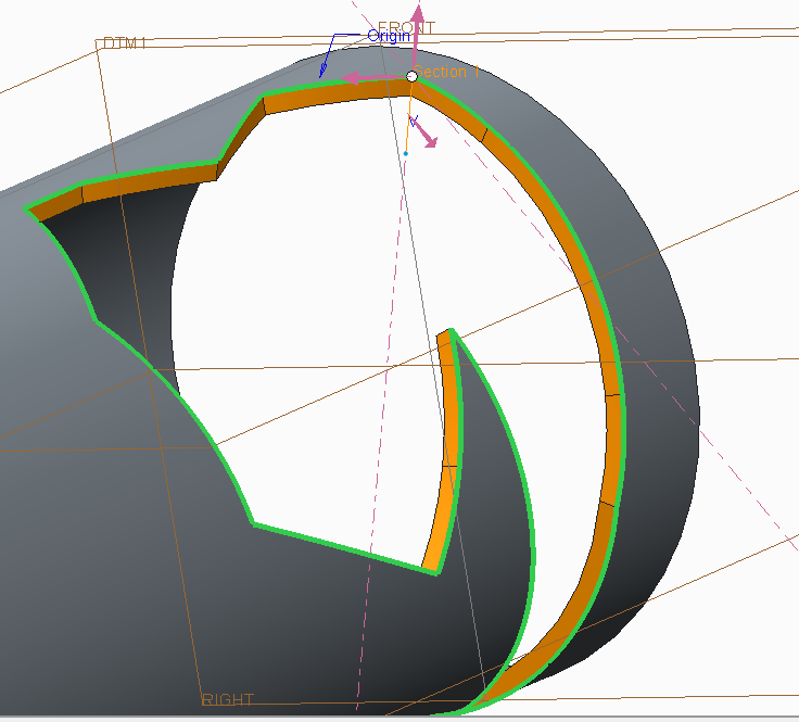

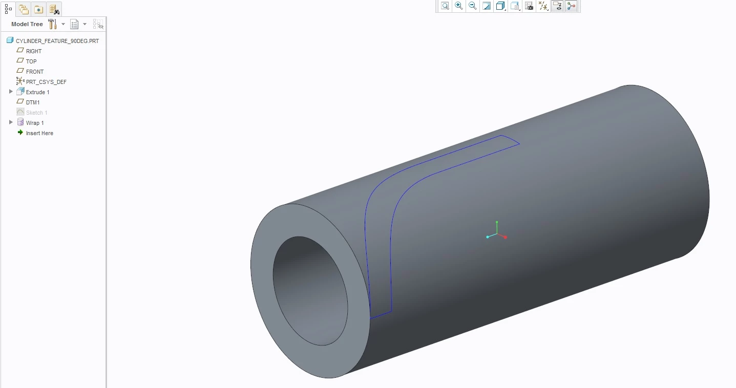

I need to remove material from a Wrap feature on a cylinder.
I've been trying to get this done, but apparently Creo doesn't recognize further actions for the Wrap feature. Why would I need that feature if i'm not able to extrude or remove material from it?
Please, someone fluent on these PTC enigmas, HELP!
There is a picture attached for more information.
CC

Not sure why the Wrap feature isn't usable - what are you trying to do with it?
In anticipation, it should work as a trajectory for a swept feature.

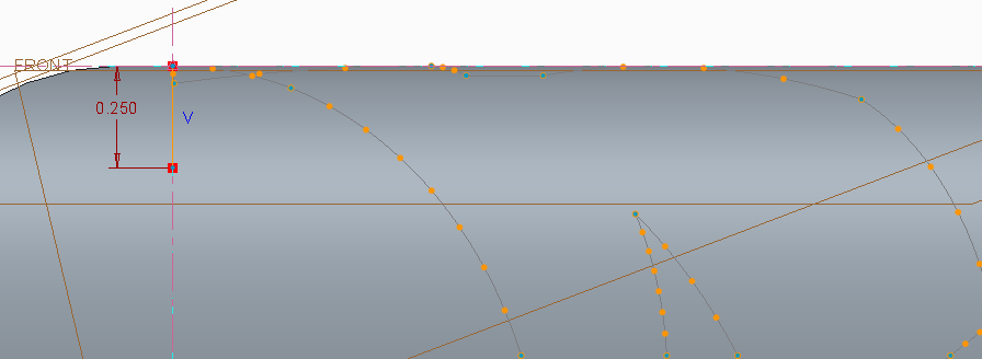

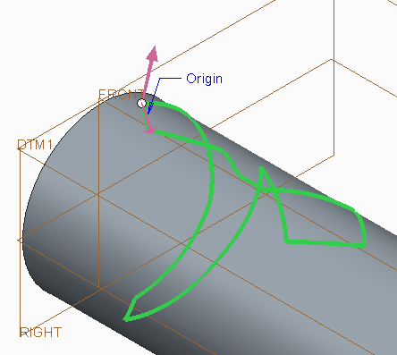

I actually ran into this problem a little while ago. You have everything correct in your model tree, now you need to add a sweep:
- The trajectory will be your wrapped sketch
- Then create the sweep section by clicking the sketch icon:
  - Make sure your section is at equivalent or greater than your wall thickness
  - Click the green check mark to accept the sketch, click 'remove material', and you should be good to go!
