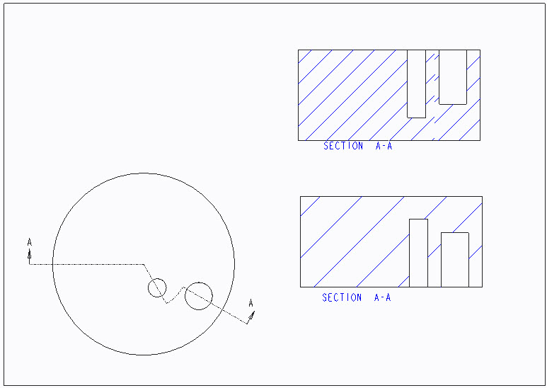

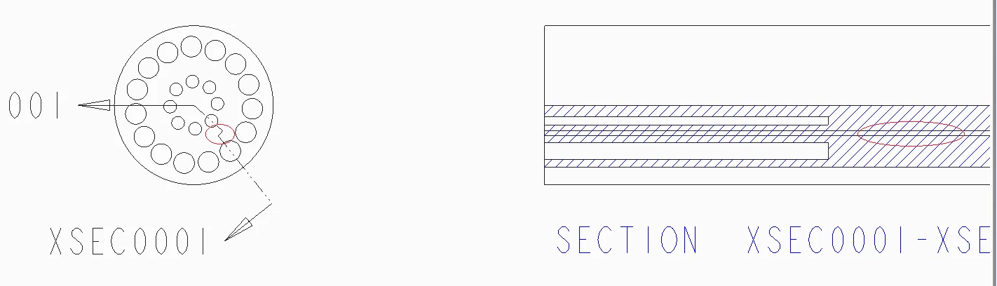

I've found the option for show_total_unfold_seam to remove the central fold seam lines from an unfolded section view, but that doesn't seem to take the cake in the attached situation below where I need to cut through multiple bolts on different patterns. True to being creo, I get an athentic view over one I can actually use. I wasn't able to select and delete the line with edge display either.
Can this be remidied by drawing the connection in the section view's cutting sketch in a different way?
